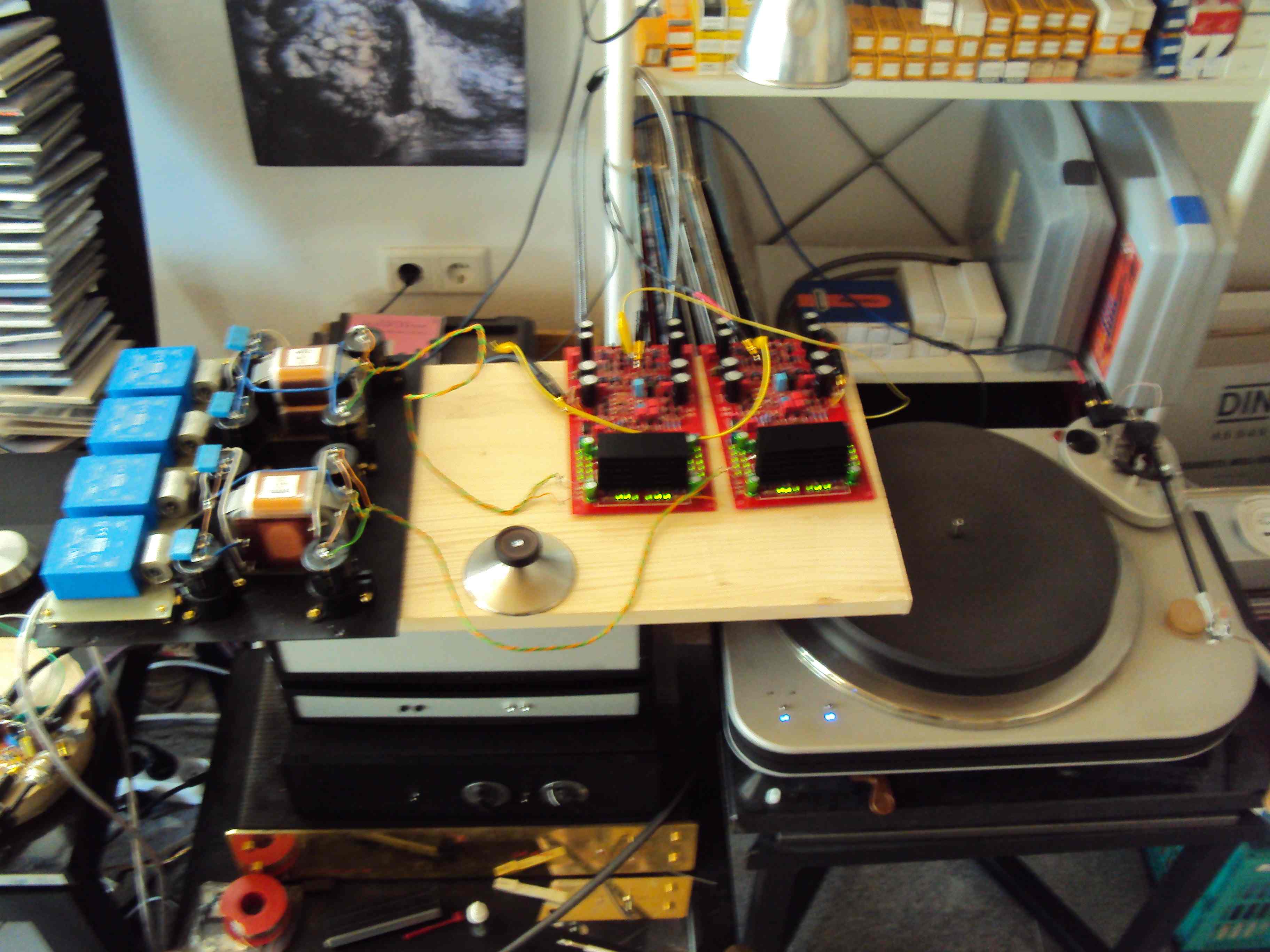

The shunt in one channel works ! No problem. I put in +-30V and around 160mA.
The 18V are easy and precise to adjust after some warm up. The cooling fins get warm but not hot. I did not have enough J310 so i put in some J112. They measure very similar and work well.

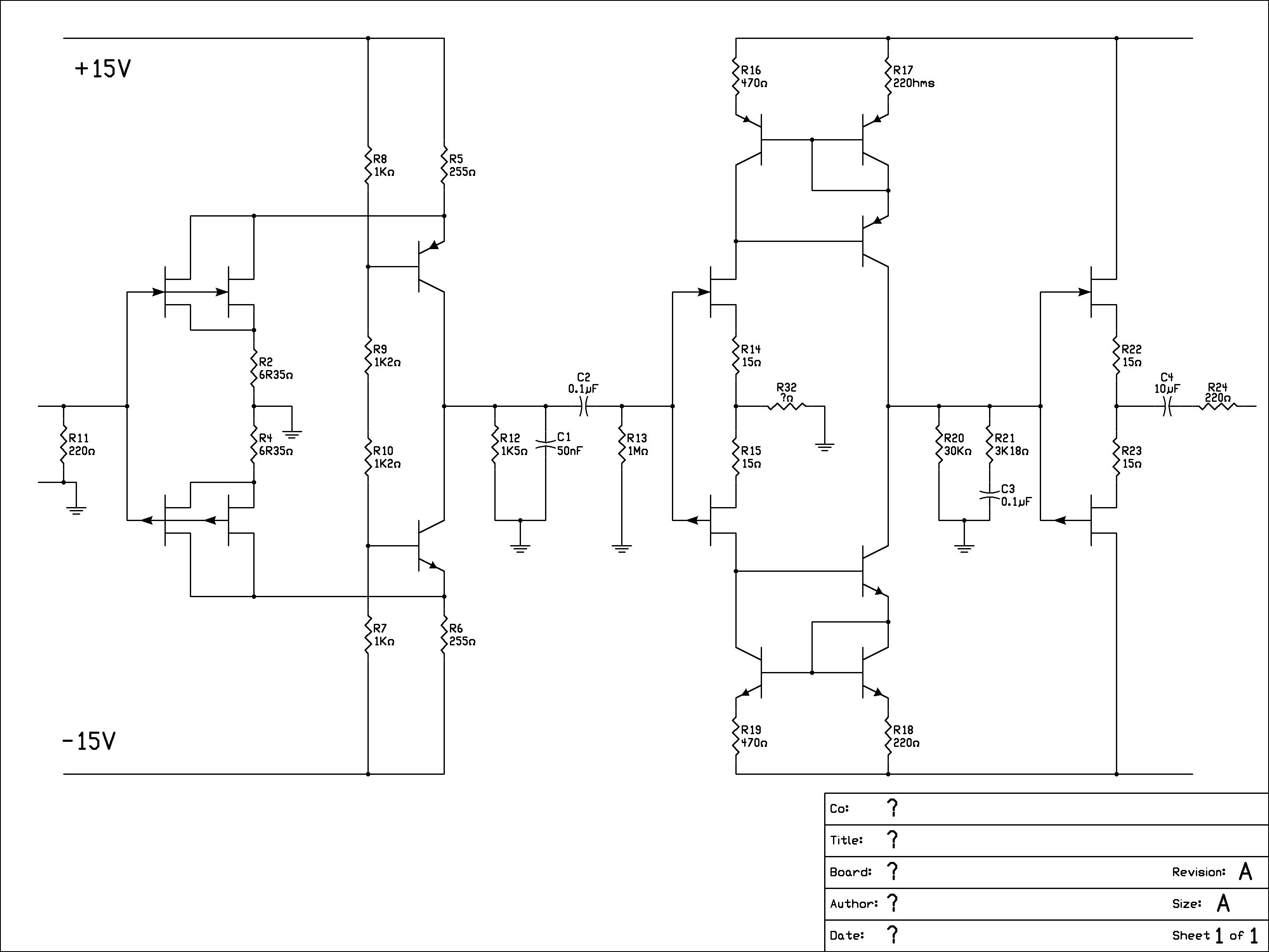

Here is my intended diagram. I am hopeing that the addition of resistor R32 in the second stage will reduce the gain in this stage so i can use the RIAA values shown without excessive stage gain, while keeping the input Jfet currents resonably high.

I like your circuit !
I have some ideas to improve it but in general it should work fine.
The 1 MOhm resistor and the output impedance of the folded cascode appear in parallel to the RIAA components so it is likely that R12 has a bit to increase.
Also R20 maybe to be raised slightly.
The biasing resistors for the folded cascode are a bit high. 10kOhm would make it.
R7 and R8 can then be decoupled with electrolytics for less noise and more speed.
The 3 transistor mirror in the second stage can be substituted with a 4 transistor mirror we use in the Paradise R2.
Anyway, i think this is a concept for now. It will work fine with some detail optimization.

I have completed now both channels and one is under current.
All voltages look normal.

Both channels are working, right away !
Not one single components was changed or substituted. No oscillation, i have not even stuffed the optional ceramics. I use only 10% Hfe matching and BCs from several makers,
wildly mixed. This is really fool prove. I am very satisfied.
