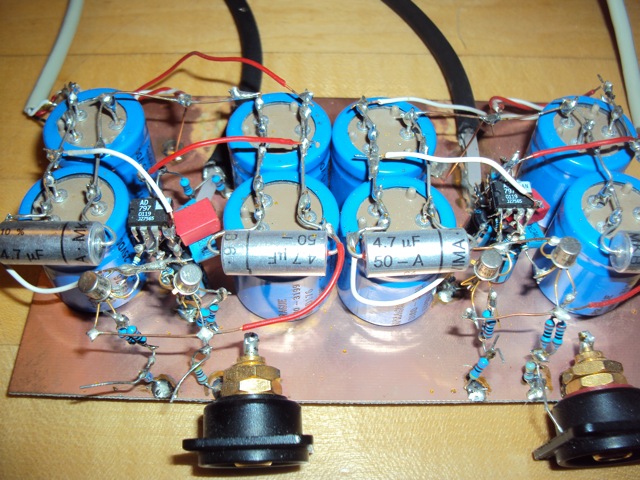

Just to be sure before I solder the parts in the heatsink, I would like a confirmation on my layout of transistors....
that arrangement is correct
