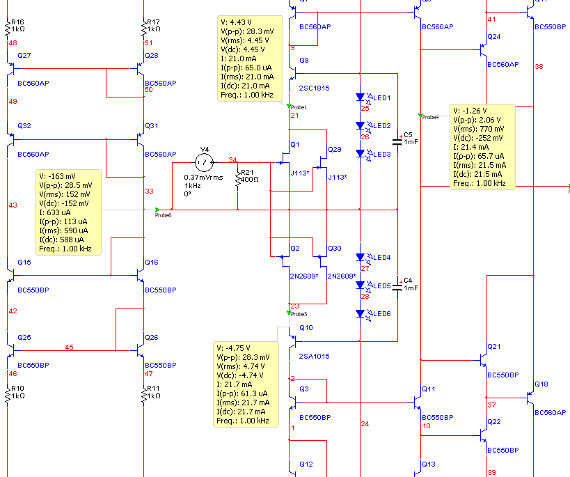

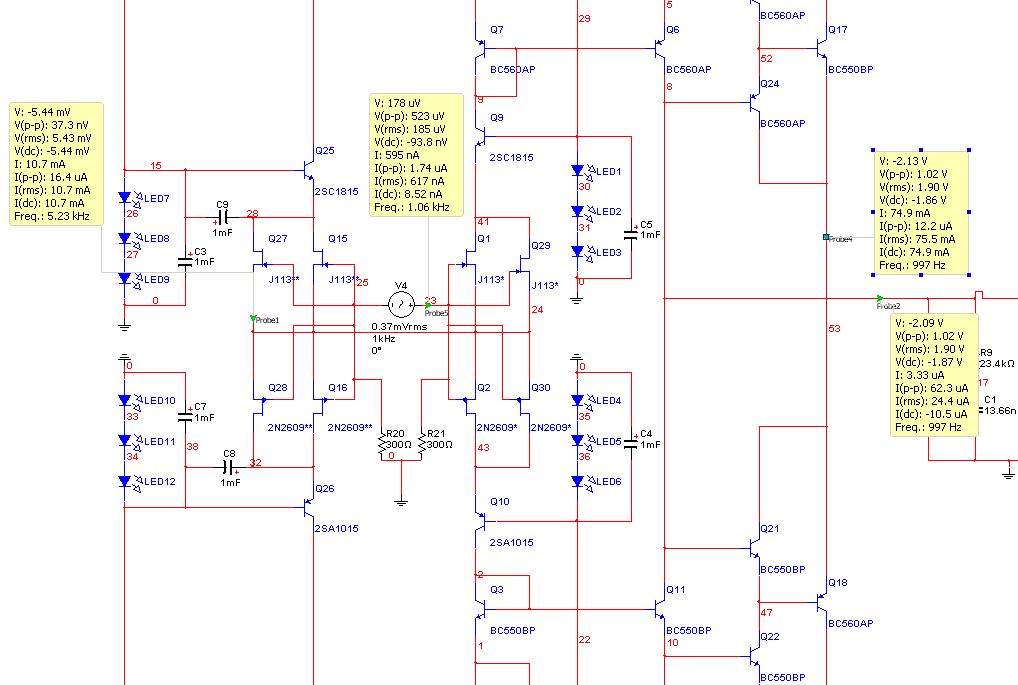

It does quite nicely 🙂 Gain dropped 3dB per same device count on a branch, so what we have here ladies and gents is balanced for sure. We have to use 4 by 4 on both sides, thats total of 16 fets per channel, to get us noise wise to same level as 2 by 2 on se. I know is no big news to no one, but thats lots of precious fets. Balanced has it's price. I look further into some issues like dc coupling tomorrow. That ac shunting caps (C3,7,8,9 in attached) are kinda spoiling picture, maybe it could be fully symmetrical horizontally too, and we could make signal summing by running opposite mirrors together and rearranging fet inputs. Then it also had balanced out for those who might be interested. Just thinking out loud here. Also, just for fun I attached how #5083 problem could be solved. I call this fighting mirrors with mirrors. But thats not balanced, just not ground referenced. Node 43 is ready for servo, so this might be useful for making se dc coupled.

Sampler, this is very good news, i really love that circuit. I am now convinced that we can make it play just fine. I like the balanced out option too when it does not compromise the single ended output. The name for this stage is simply : "Masterpiece".

Looking at the Samplers circuit again we really should make it Balanced In - Balanced Out
with Single Ended Out option. Balanced solves the hum issue ones and for all and this stage could drive Euvl´s Balanced F5 directly for example.
Converting a turntable wiring to balanced is easy. I already have a design with Klotz microphone cable that sounds very well and does not cost much to make. Also a balanced volume control is easy to make working in shunt mode, so it will sound very good. Say we have 66dB of gain and can throw out the preamplifier.

Just too check. In #5121 pic 1, R20,R21 sets our noise budget before we even begin to parallel more input devices. This is less a problem for 5 Ohm cart as we can through some 50 Ohms there (total 100 Ohm loading) and still have decent DCR of some 26 Ohms that gives us SNR of ~72dB to start with, but with higher impedance carts, that can go down to 69dB and less. This is always the case with gnd referenced diff inputs. Are we ok. with that ?
I can not see how R20, R21 add a lot of noise. They are not in series with the signal but parallel. They take away some voltage from the cartridge though. Say we have a 5,5 Ohm Lyra Titan, the input resistance is about 27x the cartridge impedance so they eat less the 4% of the voltage so signal-noise will drop by 4%. In case of the DENON DL103 we have a cart. impedance of 40 Ohm. So the resistors eat around 27%. We can solve that by raising R20, R21 to 2kOhm each, so the resistors again eat 4%. SN will be worse with the DL103 though because of the rather high self impedance of 40 Ohm that is in series with the phono stage input. When we use 4 Fets in each position for a total of 16 we will get around 77dB signal-noise with a low impedance cartridge like the Lyra Tiatn.
