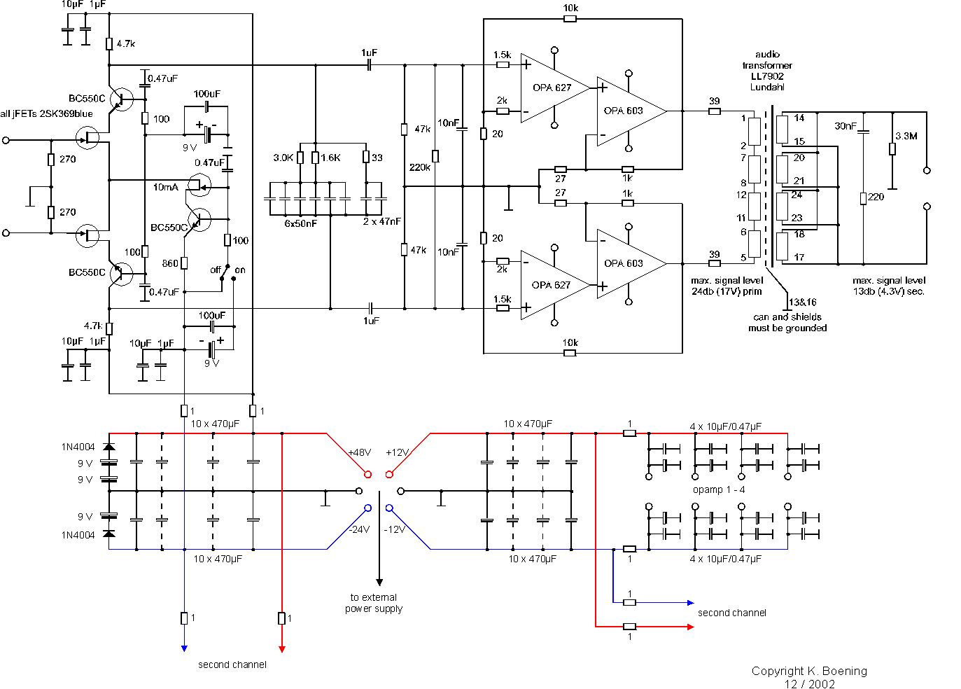

Sampler, there are other ways to setup a J-Fet based balanced input stage. Here are two of them. You can also modify the second schematic ( Claudio ) for non feedback by simply connecting the sources to ground. I think that your solution is optimum though from the standpoint of distortion because it is balanced AND differential.

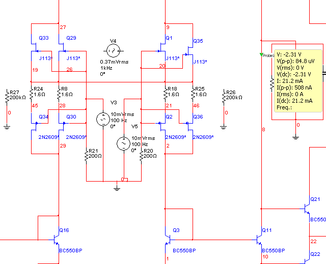

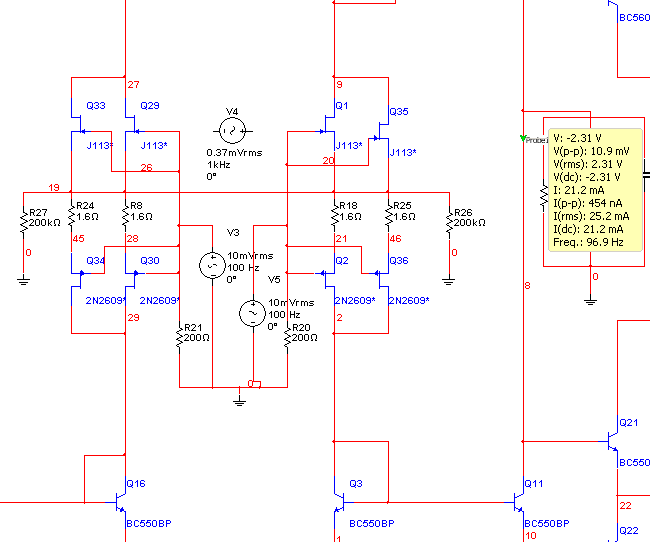

Sorry Joachim, it was too late to edit that nonsense, it's in parallel. This balanced stuff starts to confuse hell out of me. Ok, this is one version of bjt masterpiece. Lot's of gain, 0.5mV form your titan would give about 1Vrms out. Numbers look extremely good. I adopted MiiB's auto biasing, but servoing this thing is not so straight forward as we have common emitters between branches, so correcting offset on one side gives some effect on the other, but 2 servos should manage this. Still working on fet version. Can't figure out what would be the best way to servo it. Can't touch fet sources with low impedance as it spoils cmrr quite badly, so looking for other alternatives.

And I believe it works so well for couple reasons. Low gain off stage resulting in low feed through, and what gets to sources acts only as feedback. AD711 and good integrating cap doesn't spoil things. But I mentioned that we cant touch fet sources as whole common mode rejection happens there. Even 1M to anywhere starts to spoil it. I will sleep on it. If nothing comes out, it will be your call after all. We can put your strange servo to mirrors.

I my view the most shielded way is to adopt the use of two independent servo's one for each branch of the amp, I don't fancy the curl way as the servo is in the signal path injected where you'd normally inject current feedback. Hell This here is two complete riaa's with the signal suspended somewhere in the middle of it all....NICE.
