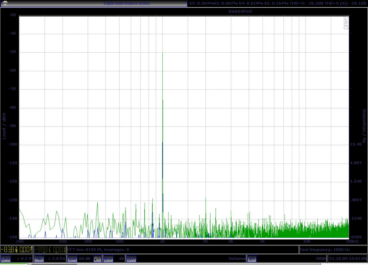

The FPS is basically a Tietze-Schenk low noise input stage, interpreted as a Fet input balanced INA. You can see it in T/S, Chap. 4 or in Burkhard Vogel´s "Sound of Silence", first Edition, page 48. John Curl send me a Fax with the same circuit from the 60th, also single ended, so this idea is ages old. A guy from Canada who´s name i have forgot made an ultra low noise single ended version although he is not a fan of the constant current sources. In praxis i found that the noise disadvantage is compensated by the gain advantage plus better PSSR. Two circuit i have in my lab prove that it is ultra low noise.
One is a single ended version with 4 x 2SK369. It is so quiet that Sam found it is more quiet then his line stage. The other is the AKSA Paris that has only one 2SK369 without source resistor at Idss. I have published measurements of both circuits before here.
I am absolutely sure that the constant current sources do no harm in noise IN THE CONFIGURATION I USE.
I dug out a measurement of the Paris, taken at -50dB/U.
That was at the time i posted measurements from my professional lab. The Paris is in green and the noise floor of my measurement system in blue.
You can see the single ended non NFB nature by looking at the second harmonic. That grows in proportion with the input signal and ultimately third is coming up too ( not shown ).
This is a single selected 2SK369 on Idss without source resistor. It is bipolar cascoded with a ground referenced cacode with a 470 Ohm, 470 Ohm base divider, signal going out of the base ! This is supplied by a bipolar constant current source with an RC filtered single green Led voltage reference. The SAM has 4 x 2SK369 on a 0,8 Ohm feedback resistor. The current source is referenced by two red Led´s with RC filter so the emitter resistor can be of somewhat higher value. Sigurd simulated that a 100 Ohm resistor adds around 1dB noise, so for lowest noise it should be somewhat higher, say 220 Ohm. this is all well researched and proven in praxis. It works.
