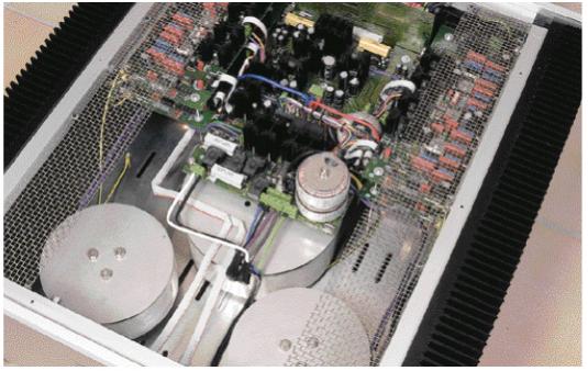

And the world's largest power-on button to this date, can be found even without wearing glasses.
No Joachim
That is not a monster it's a beauty 😛
Look at the tiny toroide trafo's in real they are like 300VA 😀
Audiofanatic 😉
This monster draws 3kW at idle and weights 180kG. It is a 4 man lift.

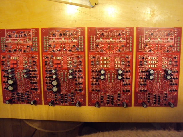

Paradise
Hey Joachim,
Aren't those my Paradise boards 😀
José
Audiofanatic 😉
My little Paradise factory.

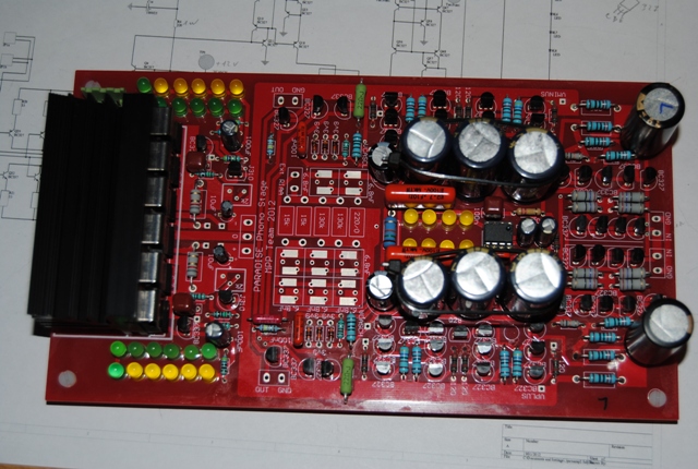

Looks good, your favorite amber Leds and the beefed up caps. You left your speciality, the RIAA, for last.
Jose, you will get the boards as soon as possible but this are MiiBs and mine. I know it´s cruel (;
Indeed... Waiting for some styrenes that can fit there... Unfortunately I did not have enough amber leds, so I used some green also 🙂
The EL caps do not fit so I had to tie them up.
Hope I do not need to do the GND thing.

looking good! my build used only green LEDs, shouldnt make a difference though.
did notice though that oscillations reappeared with long input cables, maybe MiiB or JG could advise a good way to stabilize the iput stage that doesnt degrade quality too much...
This should do the job. Only one of cause, we have single ended. At the end of the day bipolars are demodulating diodes. This also reduces RF ingress. The Horwege Phono has that at the input and it sounds transparent and dynamic. The coil is more or less a short at audible frequencies and it is well damped by the resistor. The are SMD types and also though hole. I will look up what type you can try.
