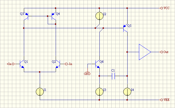

There are other compensation methods possible inside the buffer but i need MiiB on that.
One possibility is the Ahuja compensation by Dr.Ahuja.
This compensation method also improves PSSR by 70dB !IEEE Xplore - An improved frequency compensation technique for CMOS operational amplifiers
Here is a discussion about Ahuja compensation with contributions from Putzeys, Gromer and Self :Ahuja-Compensation

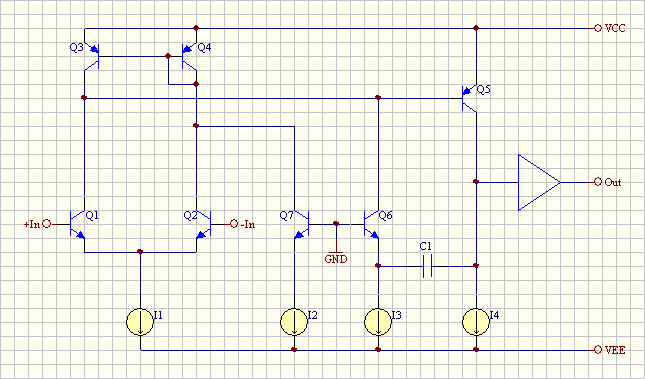

This is what i call "forward compensation" and does not shunt the signal to ground plus other advantages.
See two circuit by Putzeys and Self.

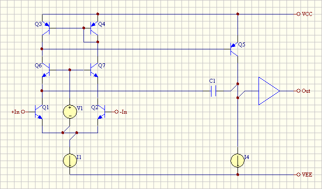

My next post will show traditional Miller compensation.

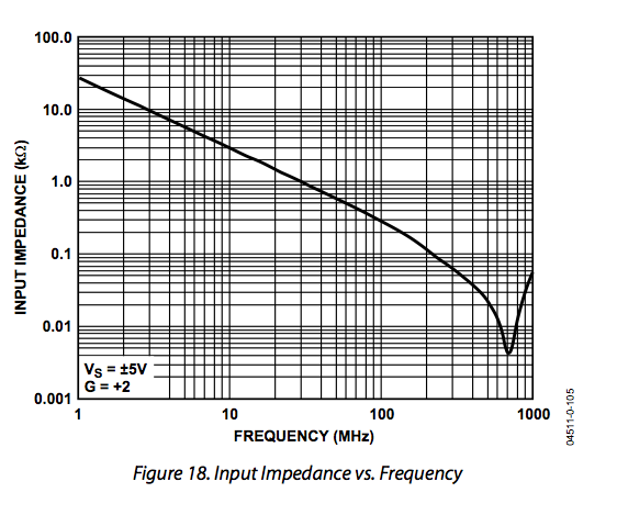

This is the problem with fast buffers. Here is the input impedance of a high speed opamp, so this is not the Pardise buffer but it is similar.
First you see that the buffer has a falling input impedance to higher frequencies. You can interpret that as an inductor. Then we have a null and then the input impedance goes up again by capacitive coupling from input to output. It would be best that from the null on the impedance would go smoothly down without rising again. That is quite hard to get because we are talking very high frequencies here. A better choice is to roll of the impedance much before that peak, say starting at 1Mhz so we have only a single pole with 6dB octave drop. That has also a good phase response because it is a first oder filter. This is what the bootstrap cap does but there is even a better solution. Stay tuned.
