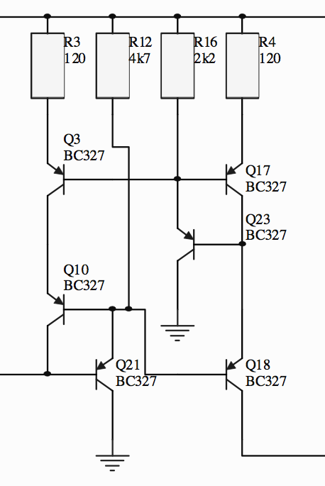

before engaging the servo...I would rough trim the offset by adjusting the current set in either the upper or the lower current mirror, not so much to avoid offset at output, but to ensure that the servo dosen't have to unbalance the currents in the gain-transistors too much
Hi Mibb
I am still collecting parts but this is very important... What is the current mirror you are refering to ?
How can I adjust it´s current ?
PS: I will start populating tonight :)
Here is the upper mirror in the input stage. I wold trim R4. It can be that you have to lower or raise the 120 Ohm value.

I think Michael suggests that you first build the paradise without connecting the servo.
A certain DC offset will apear over the RIAA. You can then trim the offset down by adjusting one of the 120 Ohm resistors in the upper or lower current mirror. When you reach a minimum you can then connect the servo so it has less to do.
Sorry to budge in, but I would not do that. Changing Re (in one leg of a current mirror) will change the gain and that may be bad also, use the servo to solve this and you will have equal gain in both legs of the mirror.

this is the only chritical piont as i see it....reason is that even small differences in the mirror resistors will cause the the riaa circuit offset values to slide up and down, as a product of the mirror output impedance (which is big) and of the combined DC impedance of the RIAA network and buffer impedance. even 1 ohm makes a big differnence...So this for sure needs some trimming. 10K trimmer i both positions would not be bad....
The buffer has a permanent -15 mV offset (in my simulations) which is corrected by the servo, So it could be a good idea to adjust the RIAA node to app +15 mV or simply 0 mV after the buffer :)
