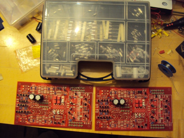

When you are totally handicapped like me this will do too :Styroflex-Kondensatoren - Bauelemente / Bauteile - Sortimente - Passive Bauteile - Pollin Electronic
This are old style styroflex, mostly non magnetic. I measured some 6,8nF and they where from 6,6nF to 7,2nF so i can get a lot of pairs.
These are in 5%. Maybe they have 2,5% too.
On the picture you can also see the Polistyren caps in 1% that are maybe even better.Compre Pelcula de plstico Condens poliprop radial FKP2,6800pF 63V WIMA FKP2/6800/63/5 na RS Online e o receber em 24/48 horas.

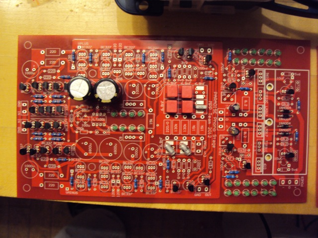

Frans, can i use 6.2V Zeners and D44H11, D45H11 in the PSU ?
before engaging the servo...I would rough trim the offset by adjusting the current set in either the upper or the lower current mirror, not so much to avoid offset at output, but to ensure that the servo dosen't have to unbalance the currents in the gain-transistors too much
I do not know. Some parts are ordered that are missing but not here yet.
Yes, the zener is good (depends a bit on the input voltage). D44H11 and D45H11 is what I use.

Here is the first take for the pre regulator.
I have used 15 mm foot print for the 100 nF
and there is space for 2 sizes of 2.2 Homs resistors.
Earth plane can be made better
and Pads for the 1uf and 100 nF Caps will need to be aded depending on component choice
+ links to Choke and 100 nF X1 caps

That can be changed no problem at all
What size PCB would you suggest?
Is the board for Paradise 160 X 220?
I assume that keeping dimension (at least the one where board connect the same may be more aesthetically pleasing?
I tried to keep Caps/resistors close to Diodes. With a bit of space just in case things get warm
Are the paper Caps ok I assumed that X1 class may be needed?
I am very happy to make any changes

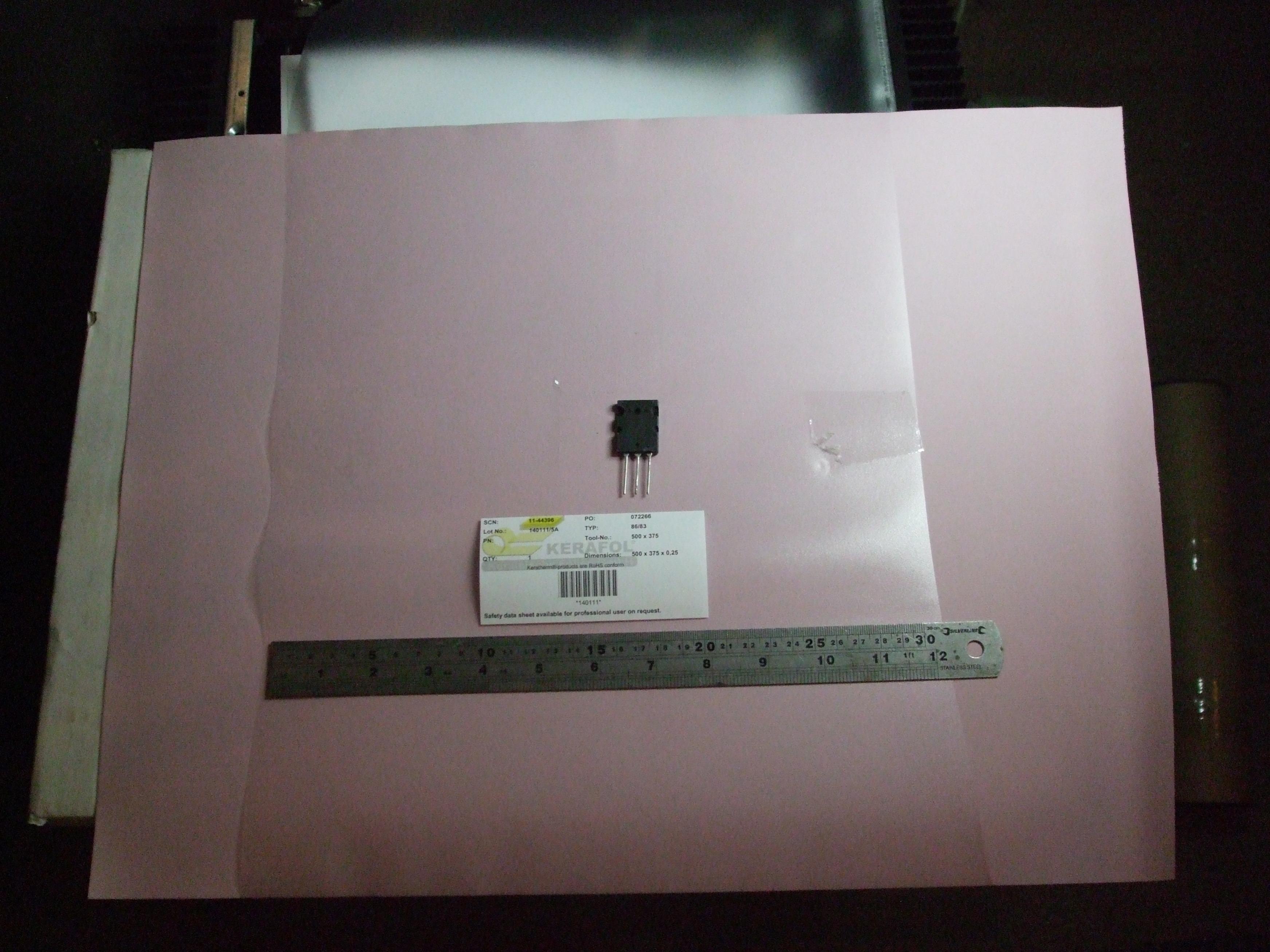

Mighty good of you and my bit.
Just got a bit of Kerafoll 86/83 that can be cut in to strips.
Berquist stuf is ok but...
