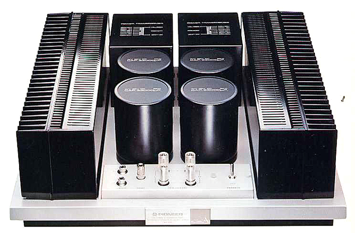

Quite similar to my upbringing ;-))) we had a Hifi shop in town that had the Pioneer M22 class-A amp, and I was so fascinated by that black machine with the huge heatsinks.... One of my systems (oh that sounds so luxurious...) is a "star of the eighties" type system, with that M22 power amplifier, luxman C02 preamplifier, sony PSX75 biotracer turntable, and Quad ESL63 speakers.
Old stuff by any modern means, but I admit I like the sound and the looks, the workmanship... A lot of it (the musical spirit) is there that I lack in more modern systems.
Of course, no match to the more modern system I have in my living room. guess its more the fun of playing with stuff, and eventually realising decade-old dreams....
