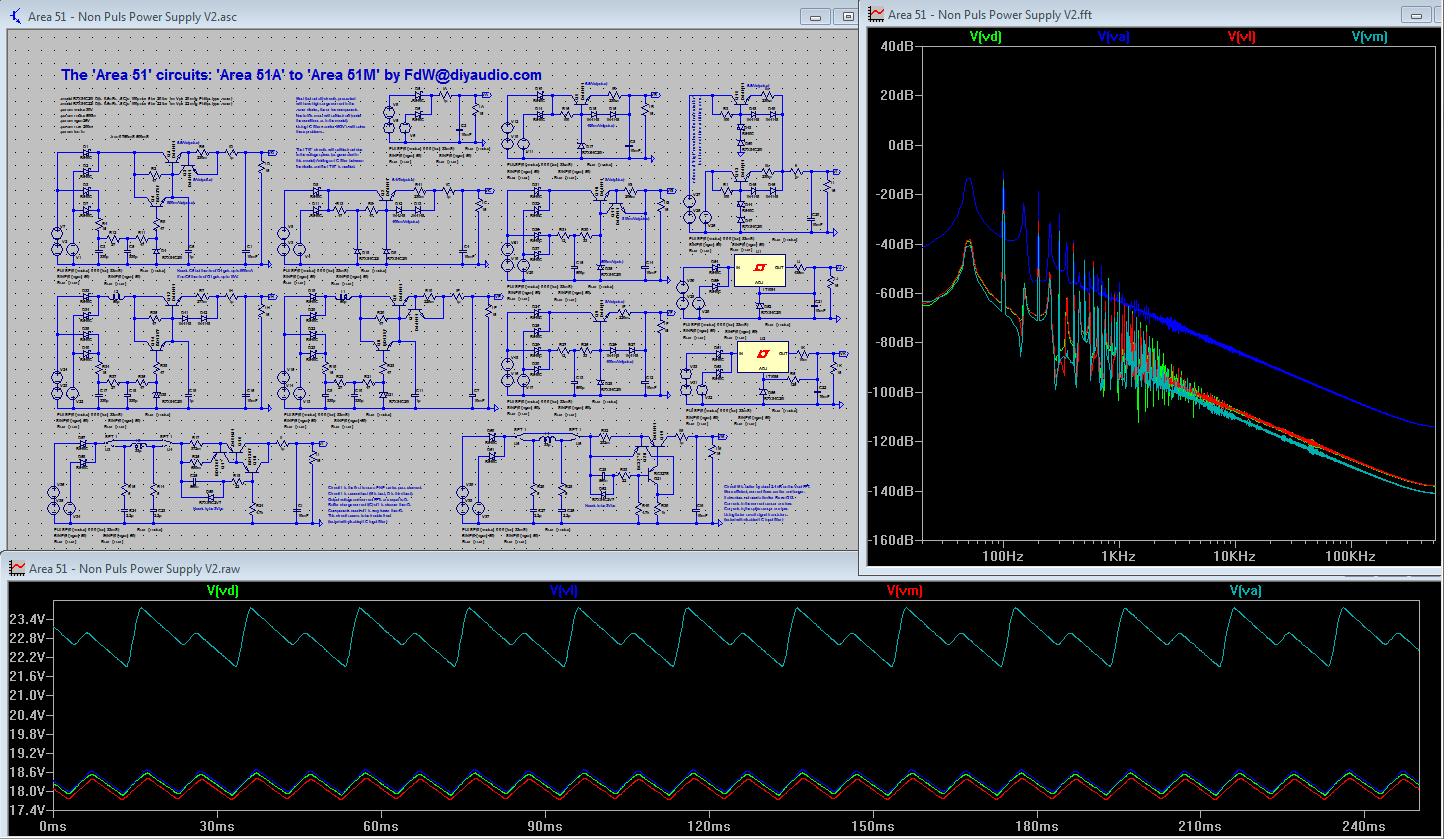

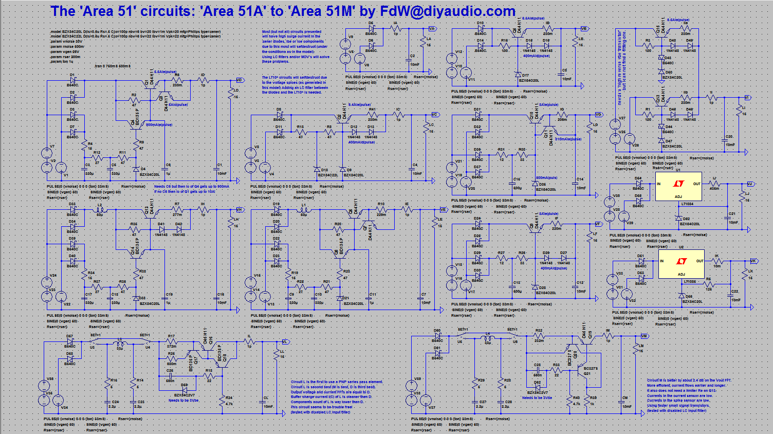

Dear All,
Although our ‘Alien Technology Lab’, short ATL, did say that they would stop working on the 'Area 51' circuit, it seems that some rogue developer(s) continued there obsessive analysis efforts.
The results, of the new (unofficial, rogue edition) ATL efforts must be kept secret (jobs may depend on this), so please keep this information to yourself (don not let it out in the open).
Attached is the extended ATL circuit collection (circuits L and M added).
This ATL technology is freely available to anyone mad (or brave) enough to try it, use the attached files with care. When using any of these ATL findings please add an acknowledgement to ‘Area 51’-component and ATL to your project.
Acting for ATL,
Frans.
Dear All,
Our ‘Alien Technology Lab’, short ATL has been working on variations of the ‘Area 51’ component. The result of the ATL work is attached to this message. Early ATL results show that the performance of the standard circuit can be improved by up to 50 dB (in the early ATL prototypes).
No further work/development will be done (on this subject) by the ATL department.
Questions will be answered in this forum.
Acting for ATL,
Frans
  • Area 51 - Non Puls Power Supply V2a.asc.txt

Frans, i like the ones with the switched coils. Do you need a microprocessor to steer this ?
The intention is to have them permanent on (in place) (is what the people at the ATL tell me). The reason for the switches is to remove them from the circuit for performance measurements (it would not be fair to the other circuits, tells one of the ATL developers).
And yes, maybe they (the ATL people) use a 'main frame' (or even microcomputer) to control this :)
Actual current ATL hardware :)
