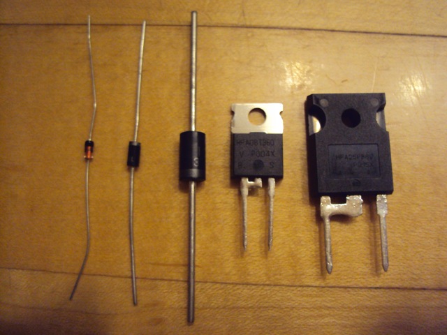

Not necessary, your Hexfred´s have around 35nsec recovery, i use them too sometimes, the QSpeeds are under 10nsec.
A Schotky has a low forward drop but not better recovery. The recovery can even be more sharp. They also have some leakage.
What we need is fast and soft recovery for little EMF.
I would prefer soft recovery over low drop, both would be nice, but loosing 1V is not very important to me.

Maybe we should use point contact diodes.
They drop only 0.2V and have superb high frequency characteristics. Junction diodes : SOLID-STATE DEVICE THEORY
I've had good success with Fairchild Stealth soft recovery diodes. For example, these have worked very well for me in various preamps that I've built.
http://www.fairchildsemi.com/ds/IS/ISL9R460PF2.pdf
And they're not too expensive - $0.75 each at Mouser.
If low drop out voltage is needed then one doesn't need to go to a point contact diode. One can get schottky diodes with very low voltage drop - it's basically the same mechanism as a point contact, with the turn on voltage set by the work function of the metal contact vs. silicon. These diodes have Vf ~ 0.3v which isn't too bad.

I have got some Hexfred HFA08TB60PBF, Ultra fast / Soft Recovery 8A
Judging by the comments I believe these are a good choice for the paradise.
