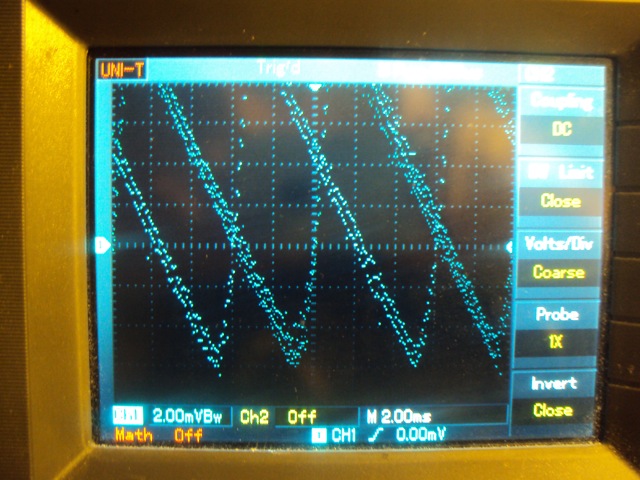

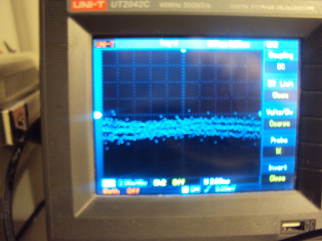

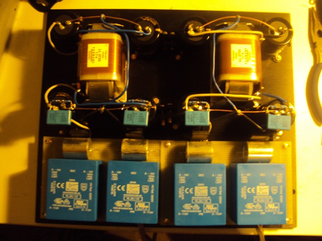

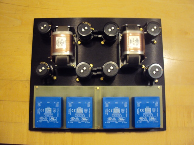

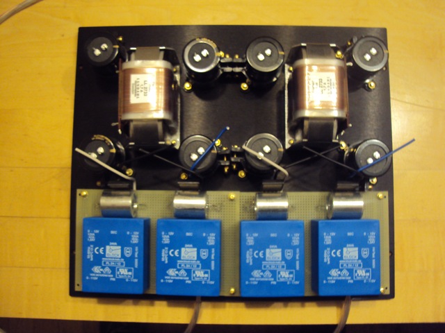

Here is the pre regulator. You can also see the waveform before and after the common mode coils.
Paradise Pre-Regulator waveform after common mode coil.jpg76 KB · Views: 432

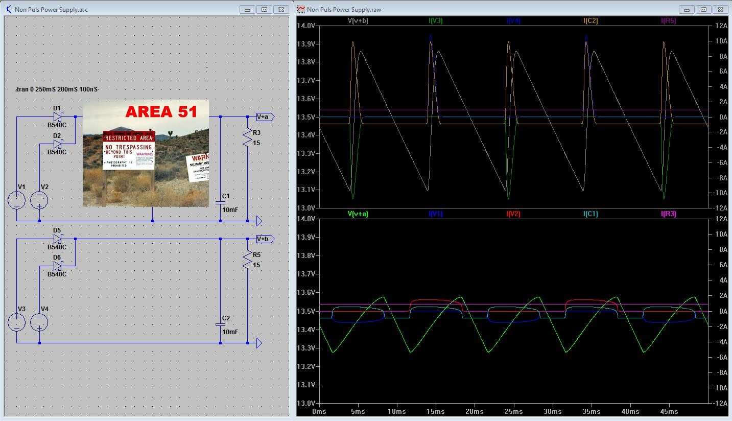

Not yet, the problem that I have is; none of the questions that I have has been answered. These questions are:
What is the purpose of the alternative circuits, like stepped rectifiers and charge transfer and are those questions addressed by the 'Area 51' component.
As I see it, the main problem of rectification, in the standard circuit, are:
1: High current peaks.
2: Short charge times (of the buffer caps).
3: High frequency components due to rectifier switching behavior.
4: High ripple voltages (on the buffer caps).
The graphs show that all these points are (I think) addressed by the ‘Area 51’ circuit, the (my) question would be, if you look at the graphs, as shown in http://www.diyaudio.com/forums/analogue-source/154210-mpp-442.html#post2863417, and the additional information in http://www.diyaudio.com/forums/analogue-source/154210-mpp-442.html#post2863477 then would you conclude that these points are addressed or not and what other points should be addressed?
Where the standard circuit produces current peaks of up to 12A the 'Area 51' circuit produces only 2A, this for sure (I think) will limit rectifier noise. And the fact that the charging time of the buffer caps increases from short pulses to about 70 percent of the cycle time lowers the ripple on the buffer caps by 50 percent (as the graphs show).
I would have liked to see some views on these points, so for now I repeat the questions and hope to see some views (not on what it is and how it works, these are not relevant in light of the noise (and other artifacts) created).
Frans.
P.s. The ‘Area 51’ component will be shown in full glory (let’s say by Wednesday) until then, give me some insights, learn me a thing or two.

I totally agree (including on the Bordeaux) as I did say before 'I am a (high end voodoo) skeptic'. The massages about 'stepped rectifiers' and 'charge transfer power supplies' made me wonder and made me create the 'Area 51' component (I cannot help that) 🙂
The power supply as designed should be more than proficient en does not need change (in my opinion). I was just trying to find out ... 🙂
This was not directed at you, but at the people talking about these ‘experimental’ power supply enhancements. They made (in a way) that I created the ‘Area 51’ component 🙂
Any way the circuit will be posted soon.
Frans.
P.s. the links should go (as they do from my place) to message 4413 and 4449 here in Mpp.
