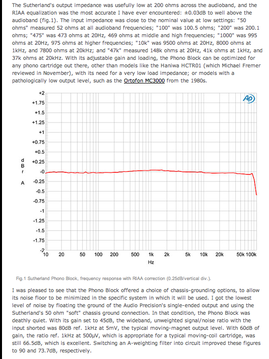

I am interested what other do and i found to my amazement a phonostage that has dead accurate RIAA. I am really underwhelmed how off some expensive models are but not this one. It is the Sutherland Mono Blocks. I am a little surprised that is uses Opamps, not because i think it is not technically sound but because it is not inexpensive. I would expect more creativity for such a Gem. I know, in terms of precision and distortion they are hard to beat with discrete so when it works it´s fine with me. As a matter of fact Stereophile gave it high praise in sound quality.
It has a very nice grounding scheme. Ground can be switched from floating to audio ground on chassis to 50 Ohm resistor between audio ground and chassis. I will try that out when i build my Paradise. Overload margin and signal noise..... look for yourself.
