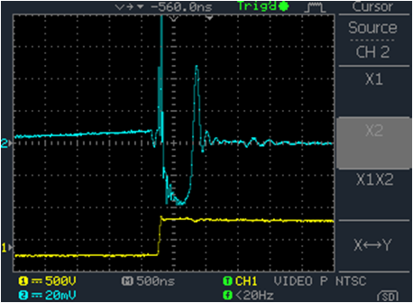

here some comments on the snubber and rectifier thing:
A faster diode (UF400x versus 1N400x) will create less noise energy but the noise spectrum will be higher in frequency. This makes it easier to filter, provided shielding is good enough. Check out the attached pictures ("slow" and "fast"), this application was a swithc-mode power supply but the pictures illustrate the moment when the current in the diode changes. The blue line has been taken wiht a magnetic field sensor (see bcarsten.com how to build your own). Slow diode has a lot more energy in the areas above and below the curve, as compared to the fast one....
The reverse recovery (and in some cases not relevant here, the forward recovery) of a diode causes a current spike that can make resonant circuits in its surrounding ring, and the snubber needs to be designed to reduce the side effects. So the cap will allow you to set the frequency (within limits), and the resistor is needed to dampen the amplitude (q factor of this resonant circuit). The values will depend on the diodes and other circuit elements used (pcb etc), so its hard to give a formula. There may also be component variations.... with a fast diode, best to try e.g. 10 ohms and 10nF and then check the magnetic field, so you get a fast decay without the nasty spikes.
SiC (and GaN) diodes, as well as tube rectifiers, have hardly any (or even no) reverse recovery charge, removing a big portion of that problem straight away. Only problem is the price (SiC) or size (Tubes)
The lower-impedance the input rectifiers are, and the larger the capacitors, the higher the current spikes will be. If the load current is (comparatively) small, the "conduction angle" (the % of time the input rectifiers are actually conducting) gets smaller and smaller. This is good and bad - the shorter it is, the longer is the time the power supply is actually isolated from input noise. At the same time the current spike is of course higher so that needs to be taken care of.

Thanks Hesener, this is interesting. Is it this one ? - Hfield
Actually i have build my own sniffer probe, but for detecting noise in turntables. It is actually a phono circuit with a coil at the input. Placing that coil near the motor i can even hear un perfections in the belt when it moves across the pulley and also the reaction of the motor. When a blemish in the belt moves over the pulley the motor makes a strange noise. As pickup coil i use an air core inductor of rather big size.
Yes, thats the one. We use it to detect magnetic hotspots in power supplies. The inductance of 10turns is very low, so it only works well at highish frequencies, but if you increase to 100 turns or so it should be fine. Or put a little piece of ferrite in there....
Depending on the strength of the field, you don't even need a preamplifier, most scopes can detect the signals fine (at least from power supplies - the more subtle stuff happening 70dB down of course not...)
