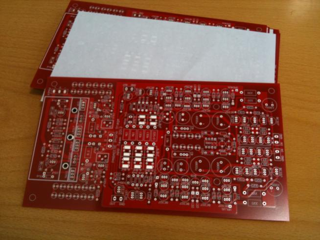

Hi guys, lots of PMs flying around - before we all get excited: the first bunch of PCBs is kind of promised, but once they are verified and final changes implemented I will organise a group buy, promised!
Yes, the designers have to sort out first if there is any bug. This is not your typical easy DIY project and it does only exist in the simulator at the moment. I do expect though that it will work.
I had a short conversation with Hesener. He did not design a pre-regualtor board so far so this has to be build the old fashioned way at the moment. If enough interest comes maybe i can persuade him to design a board for this too, or is that something for you Bksabath ?
I am hapy to do aniting I can.
But seeing hesener design and first batch of pcb one would not certanly spoil thing by going cheap and nasty.
I can do protos for personal use and one off boards.
But when is time to go for the full build I would not buy one of mines..😀
Could you send me SCH and component specs I can have a go at it any way.
It was posted by Frans somewhere here.
Maybe Frans should post the pre regulator section alone.
We have to agree on a power transformer. I think Frans prefers toroids.
I will look out for some.
Yes I do
I always get my transformers from Cybertron
Or:
http://www.amplimo.nl/images/downloads/ds standardrange/18016.pdf when using one
http://www.amplimo.nl/images/downloads/ds standardrange/08016.pdf when dual mono (prefered)
Yes I do
Frans.
P.s. When using toroids you should alwais put them in a separate metal (iron) box and that box should include the mains filter!
I usually use Block or Talema but they are not available in the voltages we need so let´s use the Amplimos.
r-core...
r-Cores are cool
r-core transformers
and you do not need the 'extra' metal (iron) box, but I would still do that.
The main point about the transformer is:
25VAC 400mA (minimum) for stereo or 2 transformers of 25VAC 200mA (minimum) for dual mono (preferred).
Frans.
P.s. I still do like the dynamics of toroids (and will use them (toroids that is) 🙂)
