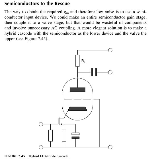

Have a look at Morgan Jones 4th Edition of Valve Amplifiers. In a balanced Phono for MC he compares the outs and ins of BJT- and Fet-Cascode,

You can have a look here, page 629 ff,

Was the cascode intended to reduce noise ?
What was the name of your audio club ?
Regards
Increase gain and reduce noise. Both.

Well no, the preview does not show the page.
Maybe you could post the schematic here?
Fair use applies.
tnx.
_-_-bear
The Fet at the bottom can be a 2SK170 for example. That combined with an ECC88 can make a low noise MC input. Well, not that low noise that we do here but something close to 1nV/qHz. That is the noise of ca.50 Ohm. The Fet has higher Gm to begin with and tubes have a rather high 1/F corner so even if they are steep they have a lot of noise in the bass. The 2SK170 has a somewhat lower 1/F frequency, not as low as bipolars though but sufficient. If you use a tube that can take higher idle current you can use several Fets in parallel or Fets with higher Gm. Then the noise can be rather low. An even better solution can be a folded Fet-Tube cascode like done by JC Morison.

Yes, the folded cascode does not profit from the PSU regulation of the top element much. JC Morison claims it sounds better though. On the positive side there is some independence of choice concerning the idle current in the Fets so several can be paralleled even when the tube has less idle current then required in the Fet section.

Joachim, yeah I see it, good point you can run the JFets current up independently.
But even so the extra supply makes me nervous. I guess one has to try it and see what the real world issues turn out to be (if any). The JFets still have to sink the tube's current, unless I am going blind again, or daffy. Both are entirely possible, even likely!

In the end it plays a role how it sounds. That can be done with various topologies.
I going into bipolars for phono and line lately. There are no more good P-channels and correctly designed a bipolar stage can have less distortion, at least in an open loop circuit.
For low impedances bipolars also have less noise.
