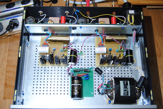

For my preamps , headphone amps and phono preamps I am using outstanding Bulgarian ANG low profile UI PCB transformers which are available to 24VA max. current, in dual mono configuration.

If you wish to avoid separate PSU box, which is of course more practical, use large and wide 2U 19 inch rack enclosure and mount transformers as far as possible from the input circuit. Primare Audio did similar with R32 phono stage.Take a look at Pass XP-15 and XP-25 phono preamps. Less expensive model is single box .

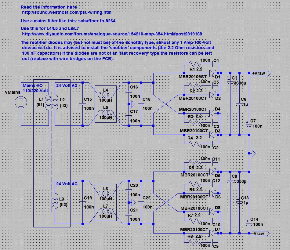

Here the mains, filter, transformer and rectifier sections, and some notes
Read the information here
http://sound.westhost.com/psu-wiring.htm
Use a mains filter like this: schaffner fn-9264
http://www.google.nl/search?q=schaf...rtPage=1&redir_esc=&ei=-5MQT6WfCsP_-gbkk-GwAg
Use this for L4/L5 and L6/L7
http://www.diyaudio.com/forums/analogue-source/154210-mpp-354.html#post2819168
The rectifier diodes may (but not must be) of the Schottky type, almost any 1 Amp 100 Volt
device will do. It is advised to install the 'snubber' components (the 2.2 Ohm resistors and
100 nF capacitors) if the diodes are not of an 'fast recovery' type the resistors can be left
out (replace with wire bridges on the PCB).
Power Supply Wiring Guidelines
schaffner fn-9264 - Google zoeken
Hi Frans
Do you use mains filter after the mains TX ?
IMO using schaffner before the TX (between mains and TX) can produce quite dead silent backgrounds but kills dynamics.
