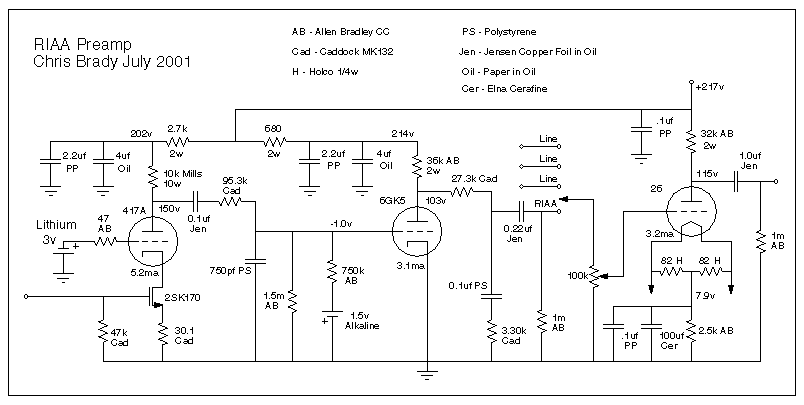

I can't and do not take credit for much at all. For this I will take a modest amount of insignificant credit. After all a cascode is hardly a new idea.
But Arthur tried the JFet/417a cascode arrangement a number of years after I decided to try and use it myself. I did not offer any sort of product with it, and built it into my own phono stage, which quite frankly was mostly the same as Arthur's.
The reason for that was that Arthur lives only a few miles from me and in the 90s I ran an audio club in the area, of which Arthur was a member. So, having met him even before the audio club started I got to watch him try almost every possible configuration of phono stage over a period of time. His original phono stage (published version) was really quite beguiling in terms of the overall sound, wonderful to listen to. But with a single 417a in the front end it was really necessary to match and select tubes with low noise. Even then it still had a bit too much noise... so I made the jfet cascode for myself. Look ma, almost no noise! 😀
To the best of my recollection, both Arthur's and Thorsten's versions of the Jfet/417a came chronologically later than the version I made. iirc, Allen Wright also tried the same sort of cascode...
Now to be accurate, I did not tell or show Arthur my circuit. But I showed it off to a number of people, audio friends, from our same local group who doubtless "spilled the beans". 😉
I would not be surprised to find a jfet lurking in Joe's Tempo phonostage. dunno. could be xfmrs too.. dunno.
I know JC subsequently used a similar front end on at least one of his custom phonostages...
ok, that's my pitch for high-end fame and immortality... ha!

I thought that Arthur Loesch was the first one that used a Fet-Tube cascode as MC input.
In the latest Tempo phonostage there is only a WE417 at the input so i may be wrong. Yes, the other Lösch ( Thorsten ) has a Fet-Tube cascode in his Toccata.

Thanks for this information. The circuit is known as the Loesch circuit in Germany but i had my doubts too. And then there can be the confusion between Arthur and Thorsten Loesch.

Hi Bear
Was the cascode intended to reduce noise ?
What was the name of your audio club ?
Regards
Please excuse my lack of insight regardings some subjects... I know a cascode can improve performance by avoiding the effects of load variation. It can also reduce miller (if present) by stiffing voltage to the lower transistor.
The Fet at the bottom can be a 2SK170 for example. That combined with an ECC88 can make a low noise MC input. Well, not that low noise that we do here but something close to 1nV/qHz. That is the noise of ca.50 Ohm. The Fet has higher Gm to begin with and tubes have a rather high 1/F corner so even if they are steep they have a lot of noise in the bass. The 2SK170 has a somewhat lower 1/F frequency, not as low as bipolars though but sufficient. If you use a tube that can take higher idle current you can use several Fets in parallel or Fets with higher Gm. Then the noise can be rather low. An even better solution can be a folded Fet-Tube cascode like done by JC Morison.

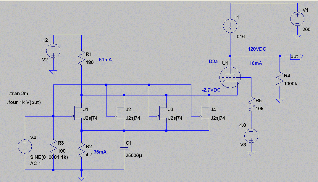

4x Jfet max otherwise it'll oscillate 🙄

You can put coils in the gates and then 8 is the limit. I even managed a prototype with 13 Fets at the input. Sometimes it likes to work, sometimes not.

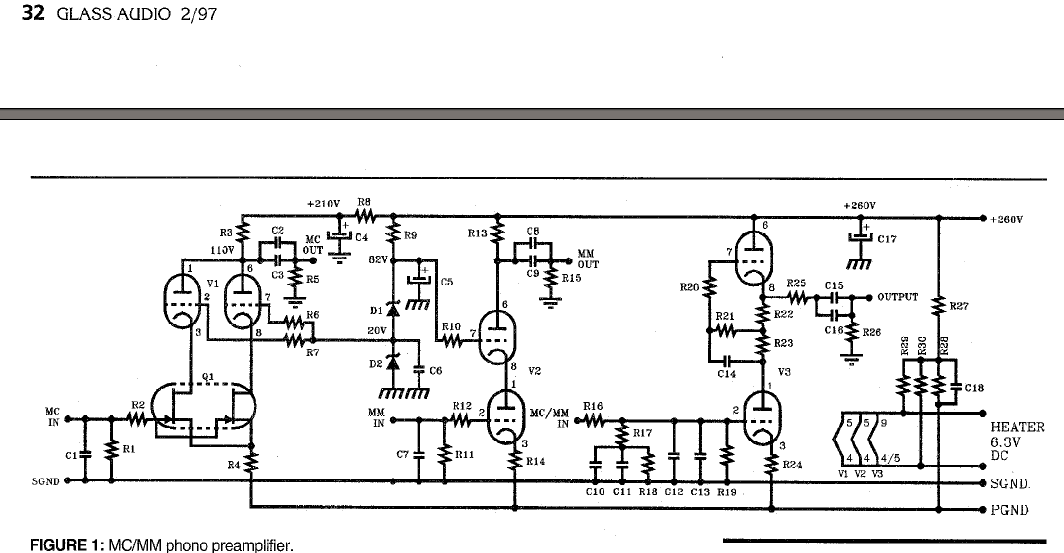

Earliest hybrid cascode?
In
http://www.audiodesignguide.com/ba/prepsc.jpg
you can find downpage "Preampl. zero feedback by Bartolomeo Aloia" .
The diagram http://www.audiodesignguide.com/ba/prells.jpg
however is not easy to read. It is pre 1988.
In
Yes, Bartolomeo Aloia did BJT-tube cascodes and also Fet-tube cacodes, mostly with 3 elements in series like in your link. He called that Totem-Pole.
