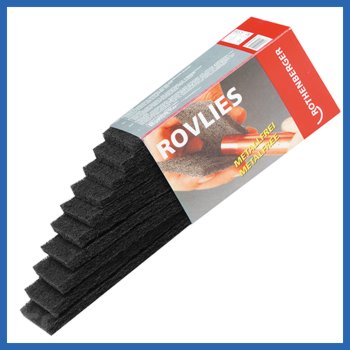

I hardware stores you can buy special plastic pads that are used to clean copper fittings or pipes for warm water installations before they are soldered. They are hard enough to clean any dirt and oxide off the leads but do not scratch them. They are cheap and work like a charm, I usually clean all leads before I solder them.
Hi Martin,
how are they called in german?
Rüdiger
I don't remember. Seriously, I went to OBI and filed through the shelves where they have the copper fittings (somebody had mentioned them on a forum before) and found them within a minute. The one's I have are black, probably 5 by 10 cm, about 1 cm thick, and several of them in a plastic bag. Or just ask in there.

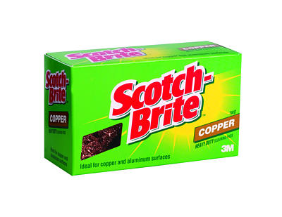

You don't mean a ScotchBrite pad ?
(what i use for everything)
