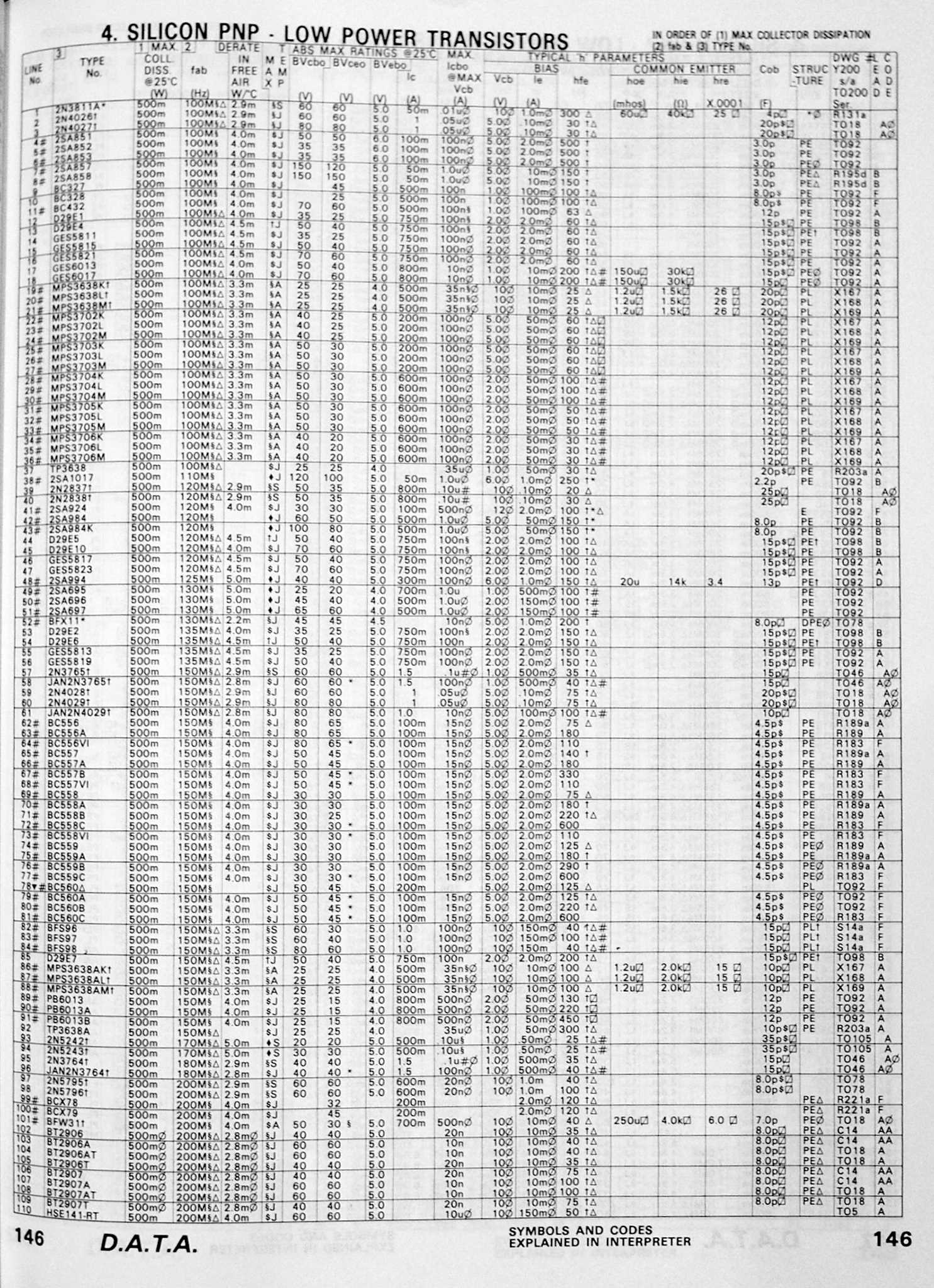

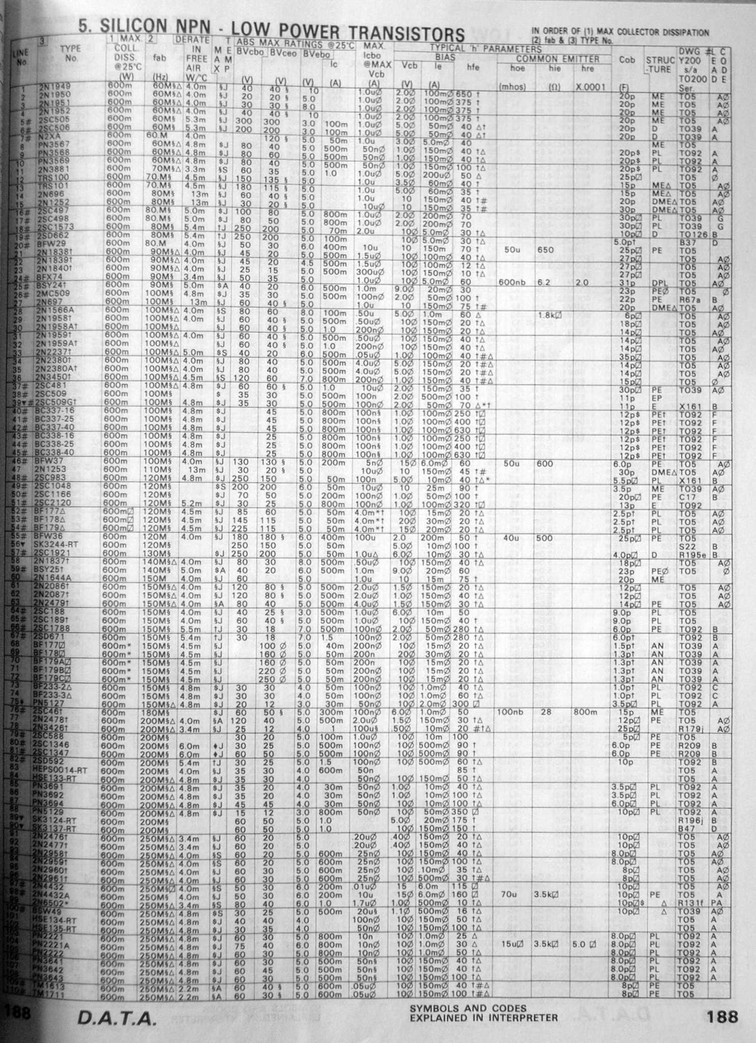

If you like it or not, here is what I have on the BC327/337. The information is from 1979.
Manufacturers listed are CEN, ELMA, ITT, MULB, NASB, NSC, PHIC, PHIN, RTCF, SIEG, TIID, VALG, NECJ, MOTA, MEHK, NSC, ALGG, FREB and RTCF.
I would say a quite popular little bugger at that time.
Page 188(left) line 40, Page 146(right) line 9
