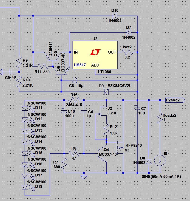

And I do have a New Year’s present.
Extensive research in the new year has led to the discovery of an small but useful improvement to the power supply.
The line regulation under extreme load can be improved significantly by replacing the 2.2K resistor with a 2mA current source. Line voltage ‘swing’ under extreme load (50mA AC on top of 50mA DC) goes down from 346uV (already very low) to 27uV (and that is extreme low).
The current source can be created by replacing the resistor with a J310 fet that has an 1.5K gate-source resistor connected (see detail schema).
P.s. I already informed Hesener and he will make the change.
P.s. Joachim this solves the ‘not so low floor’ problem in the previous FFT, the FFT floor is now about 33dB lowered. See: 3988.
Small things can have a big effect. Very well. I still like the relative simplicity and effectiveness of that circuit. I understand it even a bit so i am learning here too.
