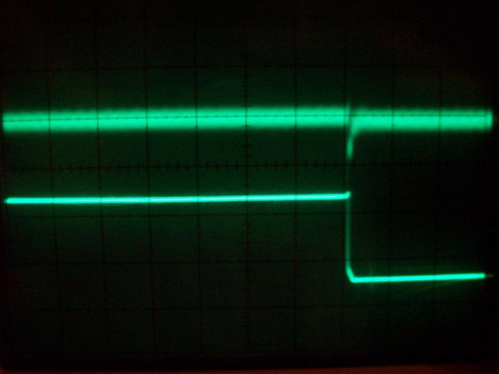

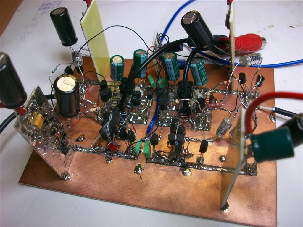

I had some spare time on holidays so I build quick and dirty version of that improved AD829 clone that we discussed in post #3248. I know it's ain't pretty, but then again, I had worse looking protos, that made 433Mhz with 140dB noise floors. I didn't saved any thd measurements, as there was nothing to measure, so harmonics are masked with noise floor which is similar to starless. Also I thrown in some shunt supply's, they are a variation of salas V1, just optimized for higher olg, BF862 for Vref, also tight smd layout made possible usage of meaner mosfet's with higher gfs. I attached measured 50mA step response (shunt current set to 100ma, rise time limited to 200ns, upper trace output 2mv/div, lower trace load switching). That's with just 1uf poli smd for output capacitance, but I could throw anything I like at output (even low esr FM's) and it would stay stable. Noise was about 10uV, as I was hitting 5uV noise floor of my LNMP. I have to do more listening, but first impression is good. Sound is maybe a little bit too analytical for my taste, but details are well preserved. After all, it's opamp topology, just heavily biased for class A, so it has some sonic resemblance, but no opamp input stage that I heard would come close to this discrete thingy. I also liked balanced input, no signs of hum anywhere ! I don't think I take it any further than this, as I really need to make my self something usable to be able to enjoy my records again without soldering batteries for switching phono pre on 🙂 So next week naked truth will have new aluminum box, new psu and ON switch.
That proto looks really cool !

Common guys, that proto is simply mad 😀 Joachim, of course I will post everything when done. Just couple more sanity checks with psu options, and maybe I should try cascoding j74/k170 with some bjt's (like in original schematics), but I'm not quite sure about possible benefits when running single lowish current pair. Well it's the way you did it, so there must be something behind this. I will try.
More pairs in parallel give you less noise into low impedances. You have to handle more current though. That makes cascoding with Fets difficult. Here the BJT cascode is better.
Also the input capacitance goes up so using MM may be a problem. You loose universality.
I do not care much about MM but some will.
