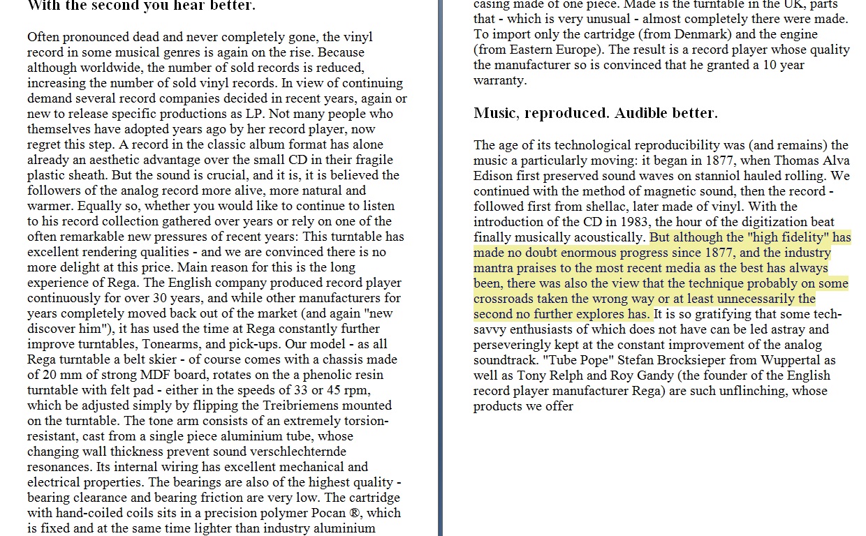

The test for the Rega turntable is quite interesting.

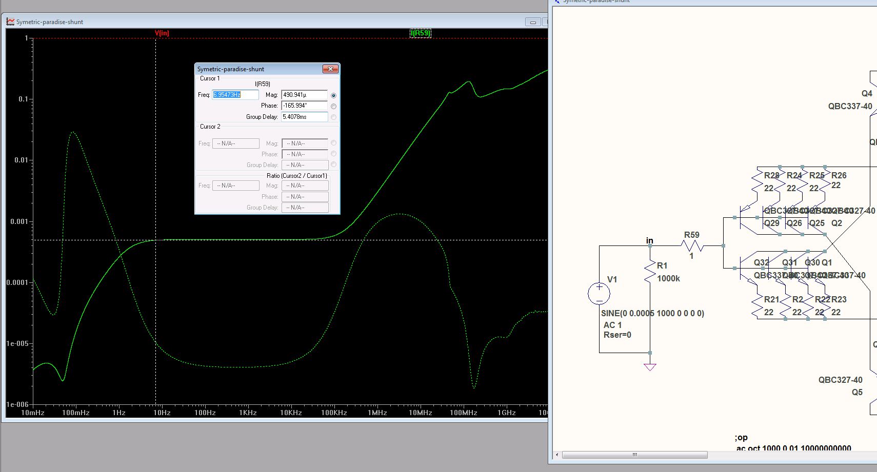

Have been looking at the input impedance, but not really sure how to set up a good measurement for this, the generator input impedance may play a role in the equation...
but according to this the impedance is app 2Kohm,,,to 100 KHz then slowly decreasing.. (input voltage is 1 V and The current is monitored)

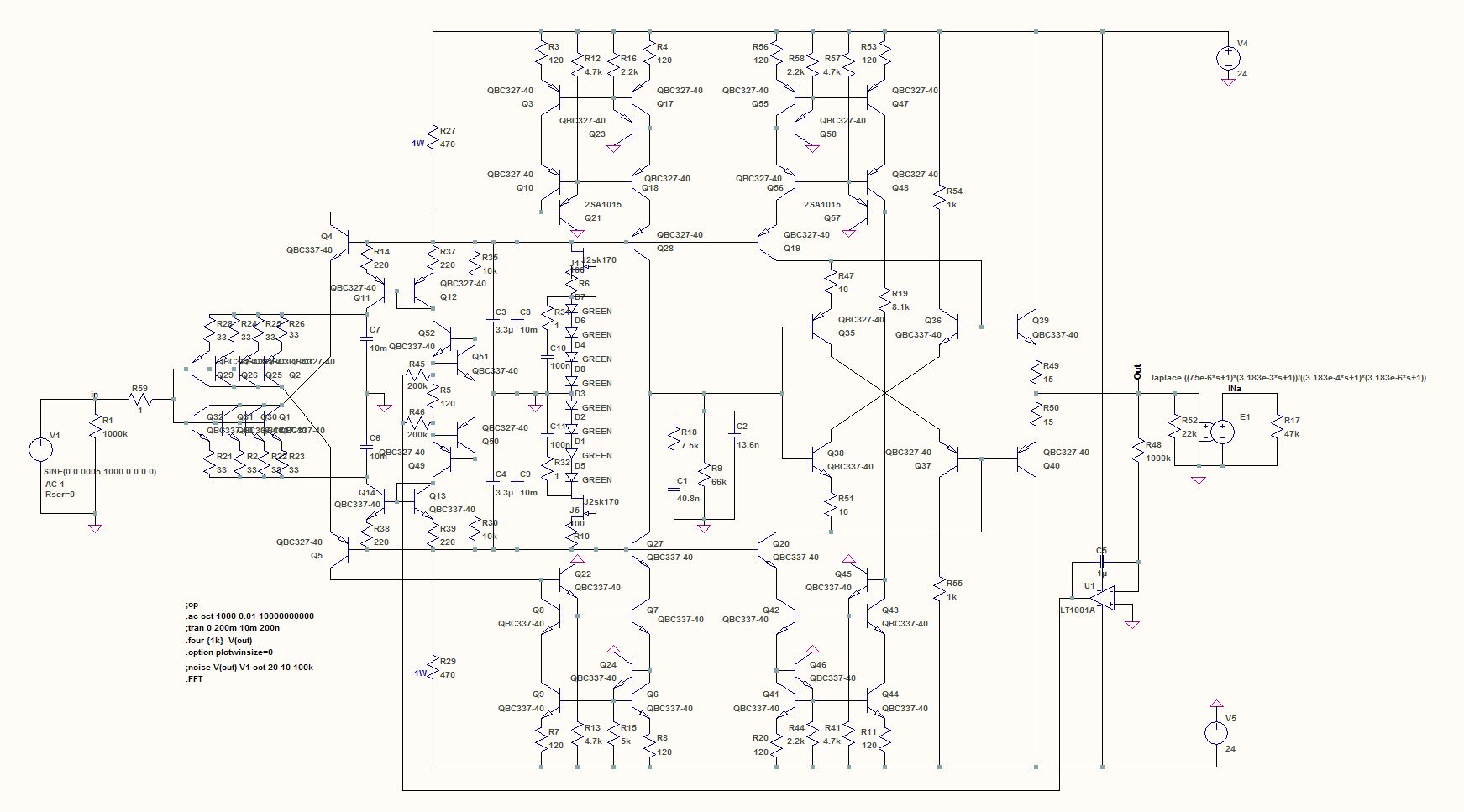

Also I have a little problem with the internal shunt, as there's no absolute reference it varies with the input-currents from the floating JFET current sources, could be a LED string reference combined with the JFET CCS's is a good solution, here I have degeneration problems as the CCS must pass app 15mA to maintain a 10 V cascode spread.

MiiB,
if you could provide me with the LT-Spice file I would look it up. Otherwise, it's though for me to see why we'd need 15mA for a Cascode reference? Same for the floating voltage issue.
Rüdiger
EDIT: yes, the voltage varies a bit when the CS fet warms. But since it's independent from both PSU noise and signal interference I doubt it matters. We should run the fet at zero tempco. I did not bother with in my phono pre, and the offset is stable around 0mV

Rudiger,, I use 10 of those mA for the circuit, 2,5 mA for each input transistor, the rest is for the shunt to work....Attached here is a version where all the deratings are OK, the maximun is 100 mW/device
A JFET Current push, will dissipate app 350 mW, and that just too much for the poor device.. and for tha JFET CCS in the mirror for the buffer it was 600 mW, so these are now changed to simple Resistance elements, I do feel that it no a degradation as we already have a very-good shunt regulated supply..
I have changed the internal mirror shunt to a CCS'ed LED refrence, at app 12 V
I have inserted a cascode in the buffer current souce, to reduce power dissipation in the Lower device....
