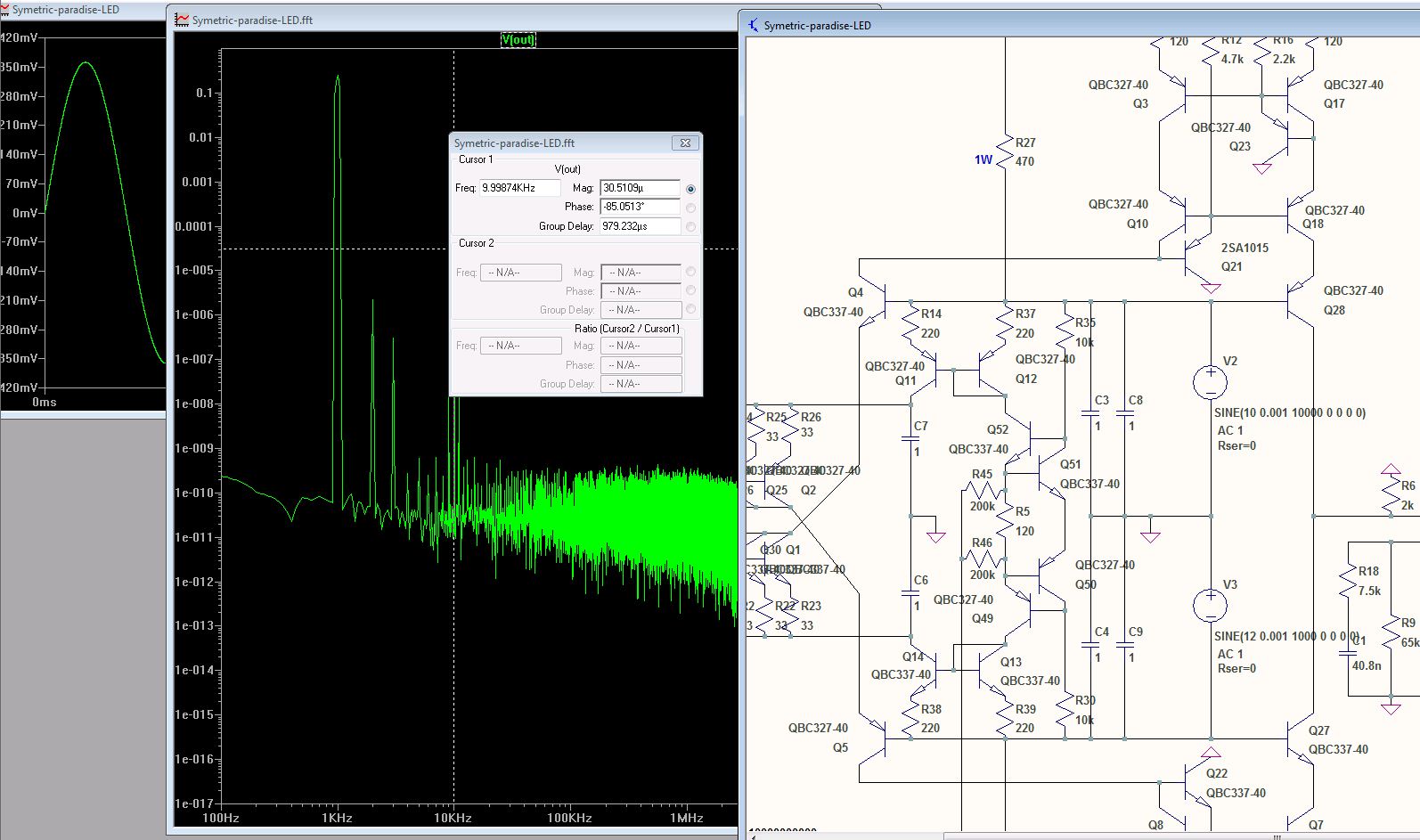

If i just have a LED string,, then there will run app 10 mA through them, here Its limited to app 2.5 mA, hmm... setting the voltage inside something,, is not so trivial...apart from using Zeners, which are said to be noisy, Will this noise bleed through..?? High rejection on the mirror and...the cascode..
Here I have inserted a dual voltage souce wit 1 mV 10KHz (noise) to see just how much a such a noise will bleed into the output, the result is that the suppression is rather large as 2mV (peak peak) becomes app 30uV, or app 70 times lower than than the zener noise injected into the circuit...
I vote for a simple 12 V-zener...

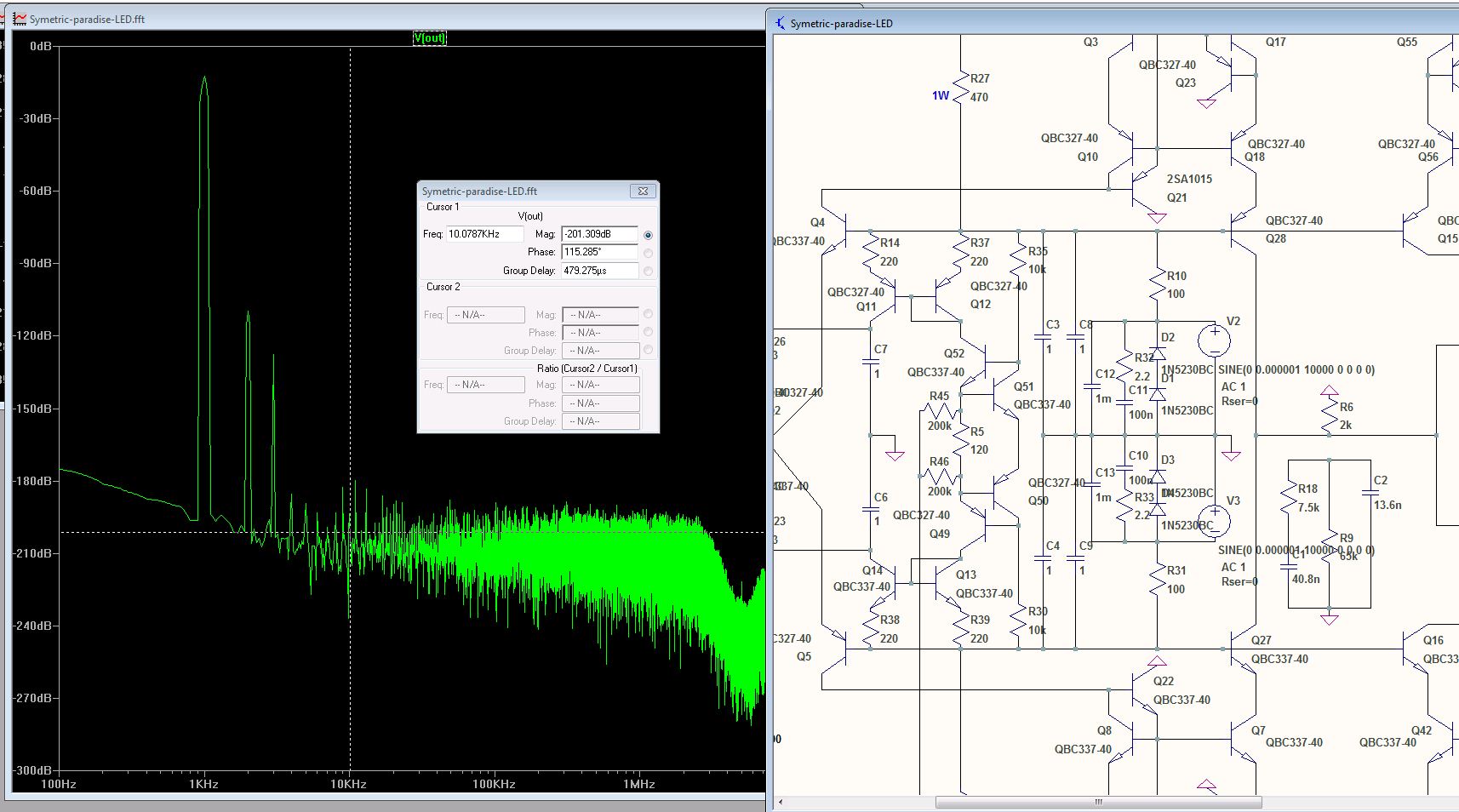

With this Zener arrangement-filtering and 2uV injected 10 KHz noise, It's by no mean visible, Think it's a plenty-good solution, and if we can agree on this, we can freeze the design...and the nice PCB wizard's can go to work...
