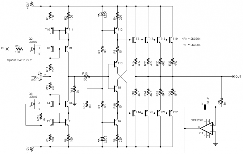

Calvin pointed out in the Euvl I / U converter tread that the Starless and Bible black stage needs a separate supply for the buffer or the output current is limited to the current that goes into the first stage. That will bring some additional complication. On the other hand i can imagine that i conventional supply feeding the input stage and the buffer could work too.

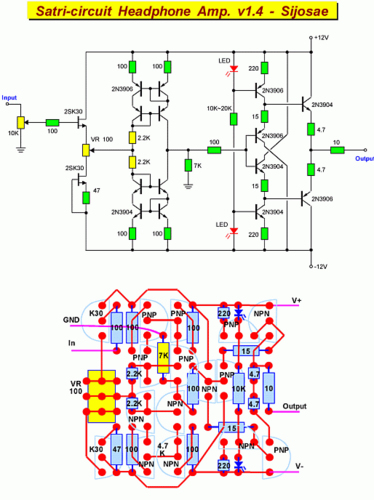

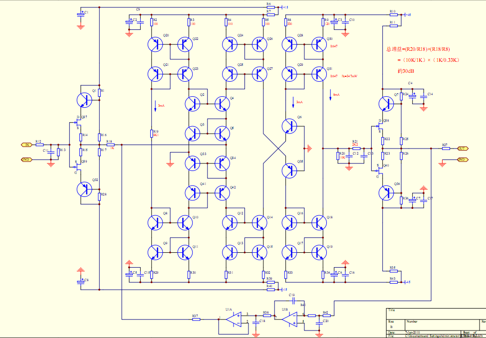

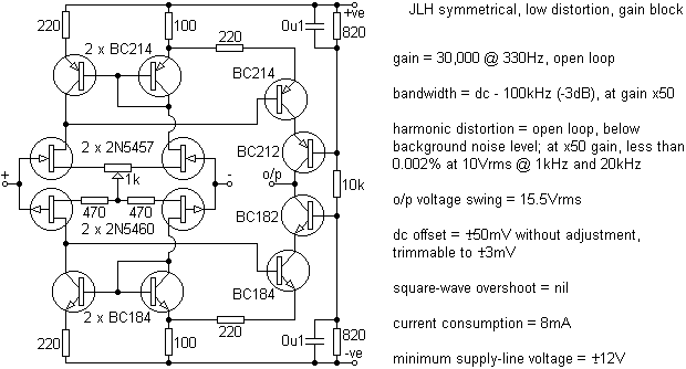

This is where a am right now....I have made a PCB..And will start to assemble when I have the last components here....It's basically an elaboration on Nico's take on Lazycats circuit...Show's some promise I think..
Interesting circuit, looks to me like the JLH pre circuit but with cascoded inputs and a ouputstage. I think Ive seen it before in a rega amp, not sure now but I remember the basis of the Rega circuit was also the JLH pre circuit. Should be a good performer.
It is this one .....

The helper transistors ease matching of Hfe because they compensate the base current.
The differential feedback resistors should lower DC offset and distortion. I have not tried it in this position. See a circuit i posted on your thread where they are in the usual position.
For an I/V converter this should work well because only a rather low value resistor is needed for the desired gain at the output to ground. For an AIOG RIAA stage i need more output impedance so putting the differential feedback resistors parallel to the mirror network screws up the desired frequency curve ( RIAA ) with the high value parts i choose.. I could try a compromise. Say 100kOhm differential feedback resistors plus lower value RIAA components. The output impedance of the fed back mirror could then be assumed to be to 50kHz but maybe i am wrong here. The disadvantage of that arrangement would be that the circuit has to throw considerable current around and that lowers dynamic range i think. To put the resistors " one story up " is my attempt to end up with a use full high output impedance and still get some benefit from the feedback. There are many other mirrors possible, for example the mirror with cascode that is NOT the same as a cascode current mirror.
