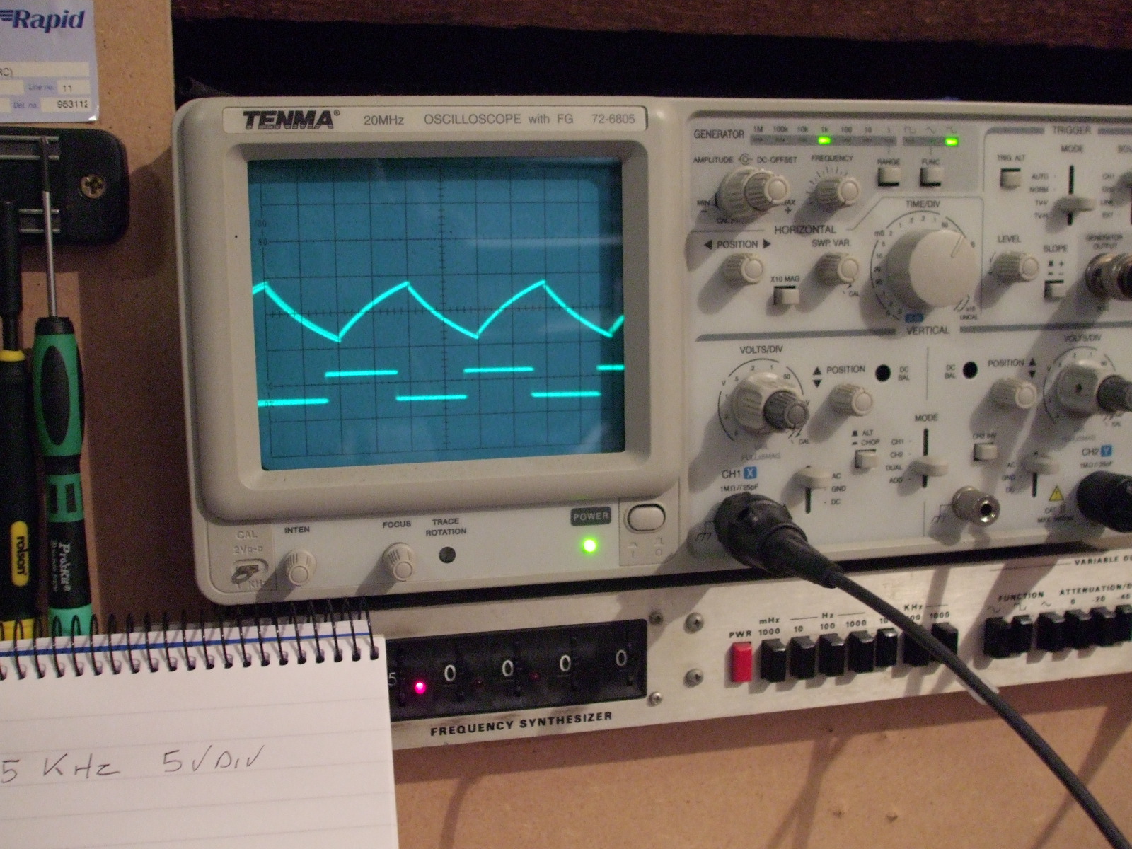

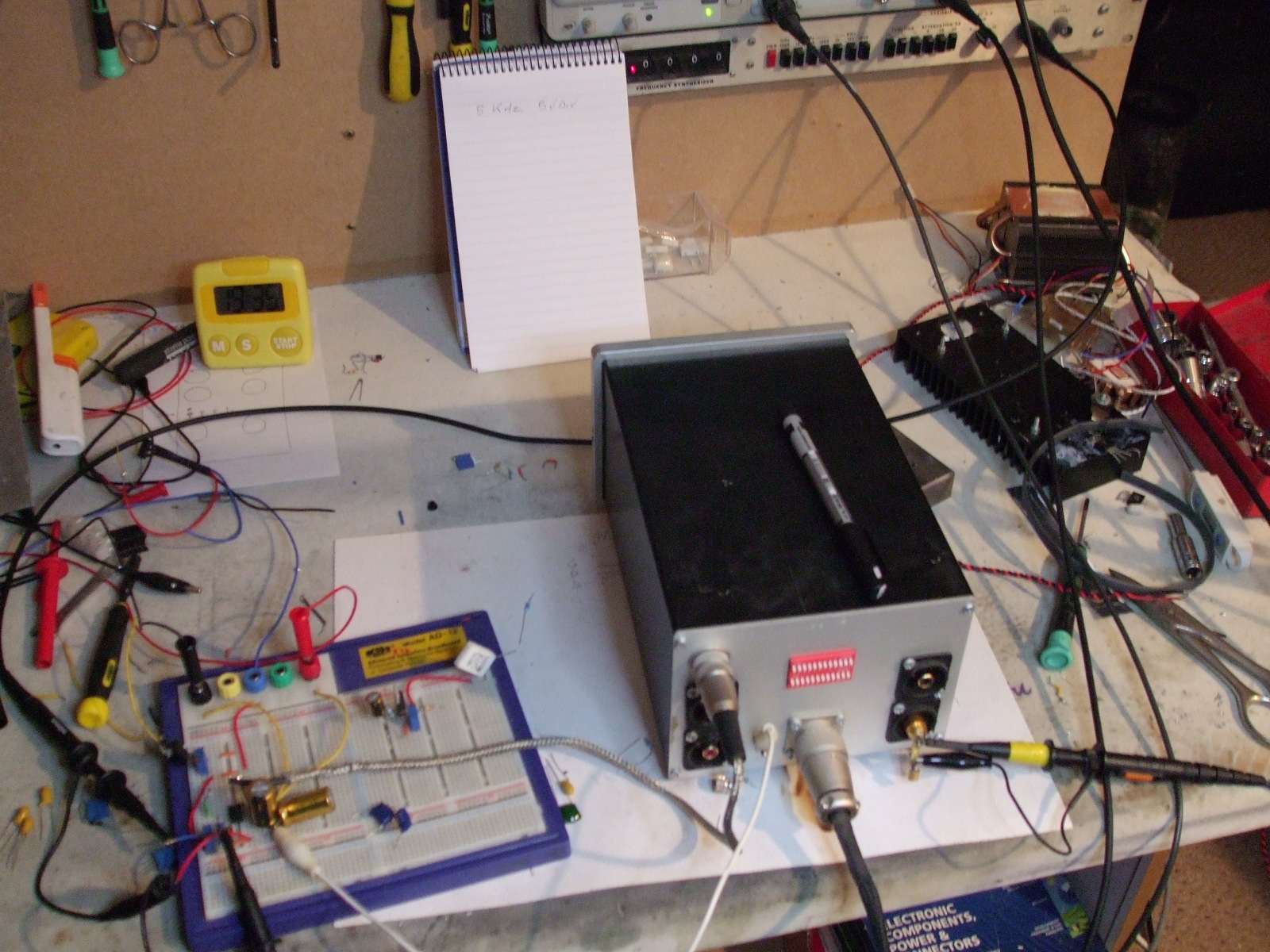

I have at present a split ria passive(easier to design for me) stage with LT1028 INA see 2 pictures
and was thinking about changing the imput and use a similar stage as the on on figure 10b in Linear Audio as output
I am using 5 LT1028 and DC servo on that and LAC sems to last a few hours (newer had to stop a listening section to charge them before)

I will get the supercaps in 4 to 5 weeks so I will firs try my existing one (I recon as LT1028 run warm 33R on feed back loops 120 mA is not too bad)
I will try to dig out the drawings for my Phono Stage so you can compare (would not expect too much from it as it is my design and I am more bolt and spanners than eletronic)

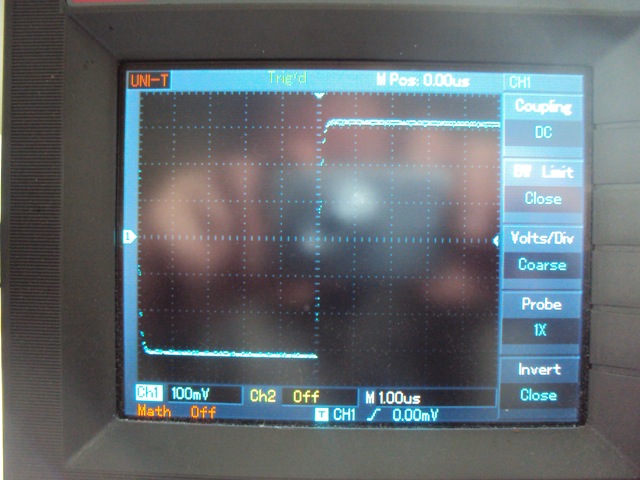

Your squarewave looks good though. The Pilgham Kit is a good value. Buying the parts yourself ( except you have them in the bin already ) will likely cost you more. If you use the 10b circuit the servo has to change. The problem is that the servo has to hold each stage constant at DC and also from plus to minus so a differential servo is needed. My original design was very funny to watch on the scope. I will ask Waard Mass to supply an updated schematic. 2595 is still experimental so please do not build it yet unless you are prepared for some surprises. I like it though. Have not seen a balanced transimpedance RIAA before.
i will have the recent FPS schematic by tomorrow. Send me a PM with your e-mail and i beam it over.
I have worked some further on the PEN circuit. I think i stroke a decent compromise. Configured that way gain is 15 x = 24dB. The circuit is fast. See the leading edge of the 100kHz square. -3dB is at 2.3MHz so my estimate was wrong. GB is 34.5MHz in this configuration. Not bad at all. I have not checked for noise and i have not listened yet though. For coupling i use 100uF Elna Silmik2. Noise can be brought down and gain can be raised by simply using more Fets in parallel.
I am very interested in this circuit but unfortunately I can not understand the way it works due to my lack of knowledge. Would you please explain it in ordinary language ?
Thank you Joachim.
It is very simple. One Fet is configured as a grounded gate circuit. That is comparable to a common base stage with a BJT. Fets are self biasing so this simplifies the circuit a lot. biasing a BJT or a conventional MOS is always trouble. The other Fets provides a constant current source. If the Fets are matched in IDss then the potential at the input is zero so no current flows into the cartridge. In fact i measured 30uV but this is low enough. Better matching then i did can improve on that but i found in praxis that even 0.1mV has no effect on the sound i can tell and does not destroy the cartridge at least when it is a Titan i like mine. Most of the current that flows in the Fets also flows in the Battery with the exception of the small current that flows into the 500kOhm resistors. This is a classical case of Kirchhoffs law. The input impedance of that circuit is low because the signal goes into the source of the Fet. It more or less short circuits the cartridge so the movement of the stone in the groove results in a current into the Fet. This current modulates the Gm of the Fet and results in a current over the 470 Ohm resistor that ultimately transfers that current into a voltage. PUHHH
