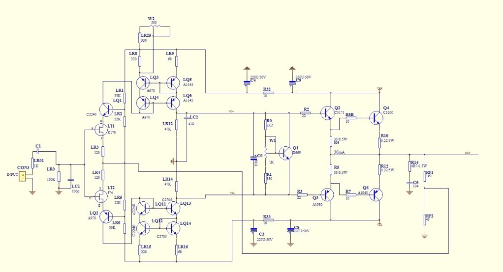

I have made PCB's for a scaled version..with Transistor current dumping ala Adyton for the output...plan on running it at 56 V rails, Get 10 PCB's this coming week.....could be possible to tweak the PCB a bit.. and cut off the current dumping part..Then your 30 W is there...
but driving from the drain is surely interesting..

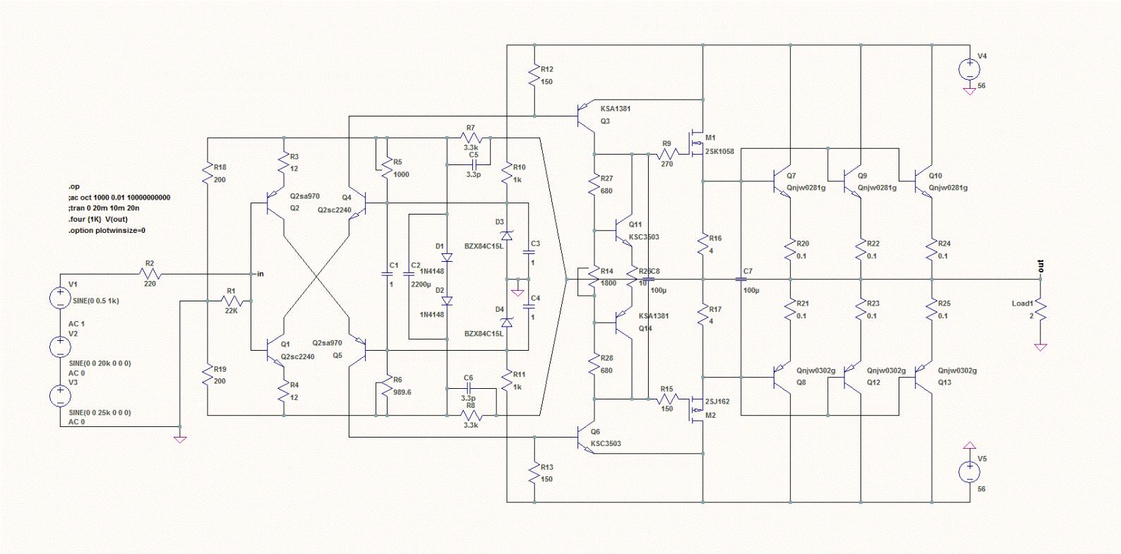

Hi Joachim.. Been fiddling around with the drain tapped poweramp...an can't seem to get i working properly...well it seems like all working points are looking nice.. current in the output fully adjustable..running a nice current (5mA) in the input cascode....But performance is really bad with 2.5% distortion even at low swings...
Will have to look more into this.. Why do you want to take the signal off the Drain..??
I mean the speaker return currents has other ways into the amplifier than though the internal mosfet-diodes...here it runs right into the feedback network..

I personally think that a mosfet amplifier driving some sets of Bipolar current dumpers is a good way to deal with complex loads,, let en bjt's do the crude current work and then let the fine lateral mosfet amplifier deal with the finer voltage adjustments..this way I believe we can get the best of both worlds...

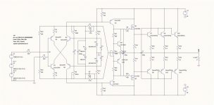

This is where a am right now....I have made a PCB..And will start to assemble when I have the last components here....It's basically an elaboration on Nico's take on Lazycats circuit...Show's some promise I think..
Looks good to me. Nice transistors choosen. That in class a could be what i am searching for.

and very very good in distortion specter....The pcb I have made is without the bias network...as I have a feeling that a pure resistor-bias is enough to keep it thermally stable...as the negative temp-co of the laterals has a higher slope than the output btj's..If not Ill have to hard-wire it...
