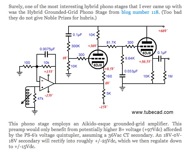

I found an interesting phono stage on the Tube Cad page. I post it hear just for completeness.

Hi Simon !

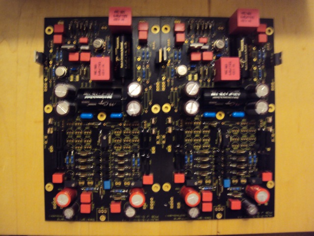

A lot of the cost is in the pre-regulator i posted. If you use a more conventional supply and use normal metal film resistors plus less expensive caps ( no Black Gates, Silmik2, Mundorf Silver-Gold-Oil ) and no metal can LME49710, OPA627 you can cut the cost down to maybe 500,-€. Also for the PCBs i used Isola G200 that is also expensive. I am planning a run of 10 FR4 PCBs that also will cut the cost down. When i get this PCBs i will post it on this forum. I could then supply the PCbs plus circuit diagram and construction hints. The transistors have to be selected so just stuffing the board does not work. It creates a DC offset that sets up the second stage so it is not easy to build it without instructions.
Hi Simon !
Is there any worthwile sonic improvement in using metal can mentioned op-amps compared to normal plastic package?
I experienced a very small difference. Certainly under the resolution of a controlled experiment. Like swapping ( decent ) cables and such. The OPA627 is used as servo so in that position an OPA134 in any package will do. The OPA827 will give even lower offset
then the OPA134. The LME49710 in metal can is not that super expensive so you could give it a shot. It looks mighty pretty on the board though.
