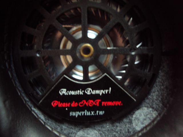

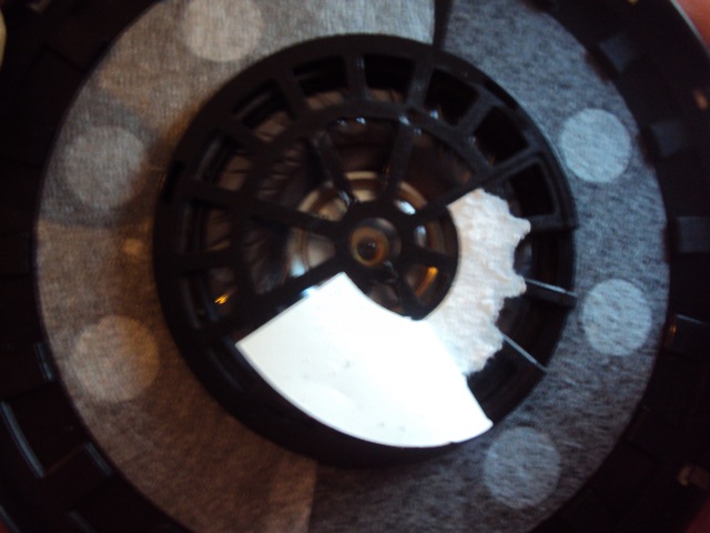

Here is what i did to the Superlux :
I removed the foam pad, that exposes the driver. A grill is put over the driver and there is a sign that says not to remove the "Acoustic Damper". That impressed the hell out of me but closer inspection revealed than one of this miracles is fixed to the front and on the other channel it was fixed to the back ! That can´t be good i thought. After peeling of the sign i got the next shock : under the sign is ...... nothing ! So it is just a piece of paper.
The "grill" does not look trustworthy ether so i cut out the whole schebang. The driver is now openly exposed. If you are afraid to destroy it put the foam on again. This headphone is very easy to disassemble and put together again. How does it sound after modification ? Without modification the sound is somewhat sharp and diffuse but also kind of spectacular, bouncy and lively. After modification the sharpness is reduced and the sound much more focussed. That may be because the "acoustic dampers" where mounted asymmetric. Can it be improved much further ? Yes and no. There could be made some radical changes to the housing but i will not do that. What i will try is coating the membrane. I will use a lacquer developed by Jürgen Ultee. Do not ask me about the recipe. He did tell me so weird things where he gets the raw materials from and how they are "cooked" outdoors because the exhaust is poisonous , so that i am not motivated to compete with him. What works very well is Dammar diluted in Spiritus.
Take 100ml Spiritus and put so much Dammer into it so that the fluid saturates. How you apply that is up to you. I think one thin coat is enough because the membrane is quite fragile and thin.

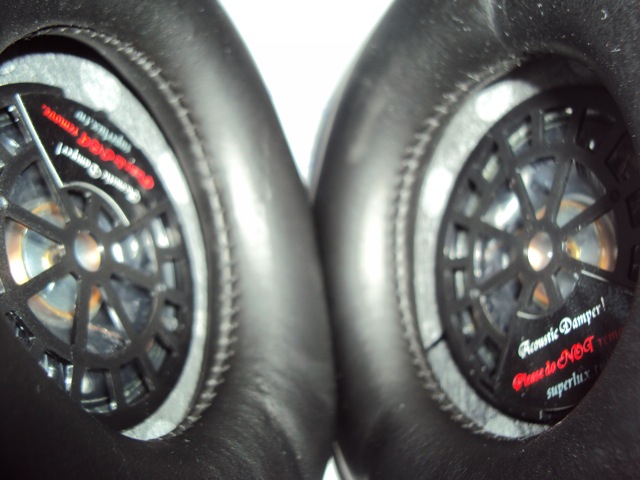

Now it looks like this ......
Very artistic modification! Dammar is usually used to varnish oil paintings, but artists
usually use turpentine as a solvent (not mineral turpentine). Does that work as well for this
use?
And most importantly, how does it sound right now?
Dammar in turpentine should work too and it smells better.
I have not coated yet but as is now it sounds better then the Sennheiser HD280 pro.
The bass is more clean an clear, the HD280 is a little "one note" boomy there, and the midrange-treble is less coloured and more even. The upper treble seems to be better resolved. All in all less transducer, more music.

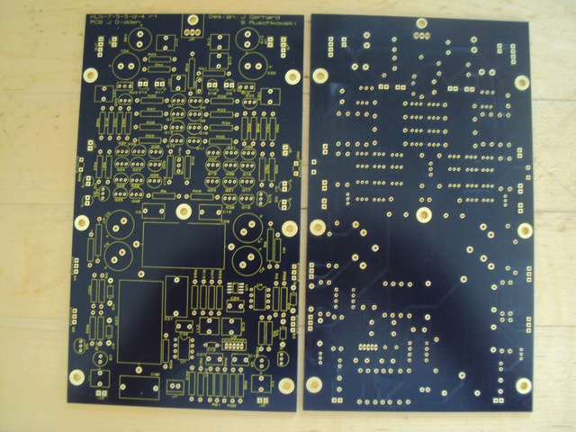

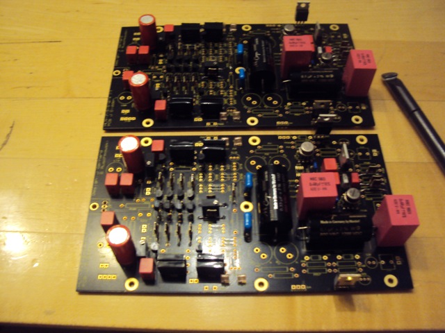

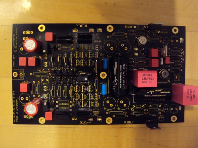

The Magnum Opus PCB´s have arrived. I spend most of the day stuffing them. This is how far i came.

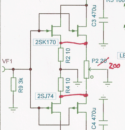

200 Ohm is maybe a little high.
It's 200 ohms in parallel with 10 ohms on each side. If you've got a spectrum analyzer (sound card fine) you can adjust to null the harmonics in getting the gain of each side more or less equal.
I do have the "Rabbit Hole" built -- and think I'm going to stop there for the moment!
