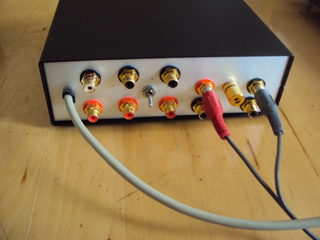

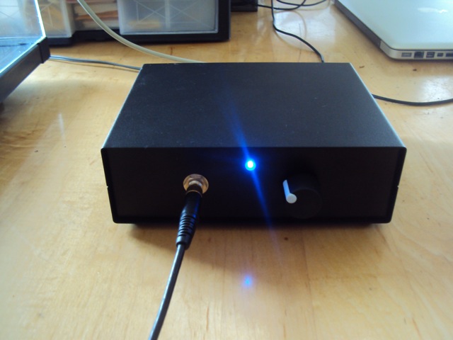

samsamsam, the good thing is that one of the phono stages will be affordable and it is powered from the new Well Tempered PSU. It has a lot of configuring options. It has MM and MC switchable and adjustable in resistance and capacitance, it has a line input and a volume control and it has a headphone amp. I will later post a picture of the prototype.
I do not want to say more because this thread is not meant for promotion.
