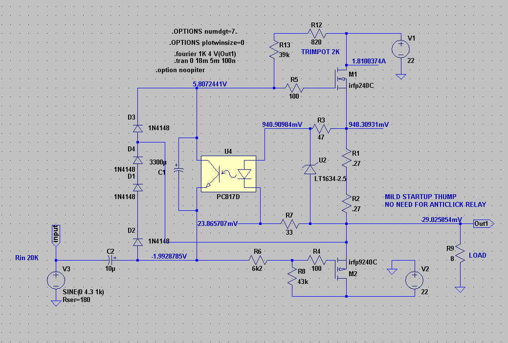

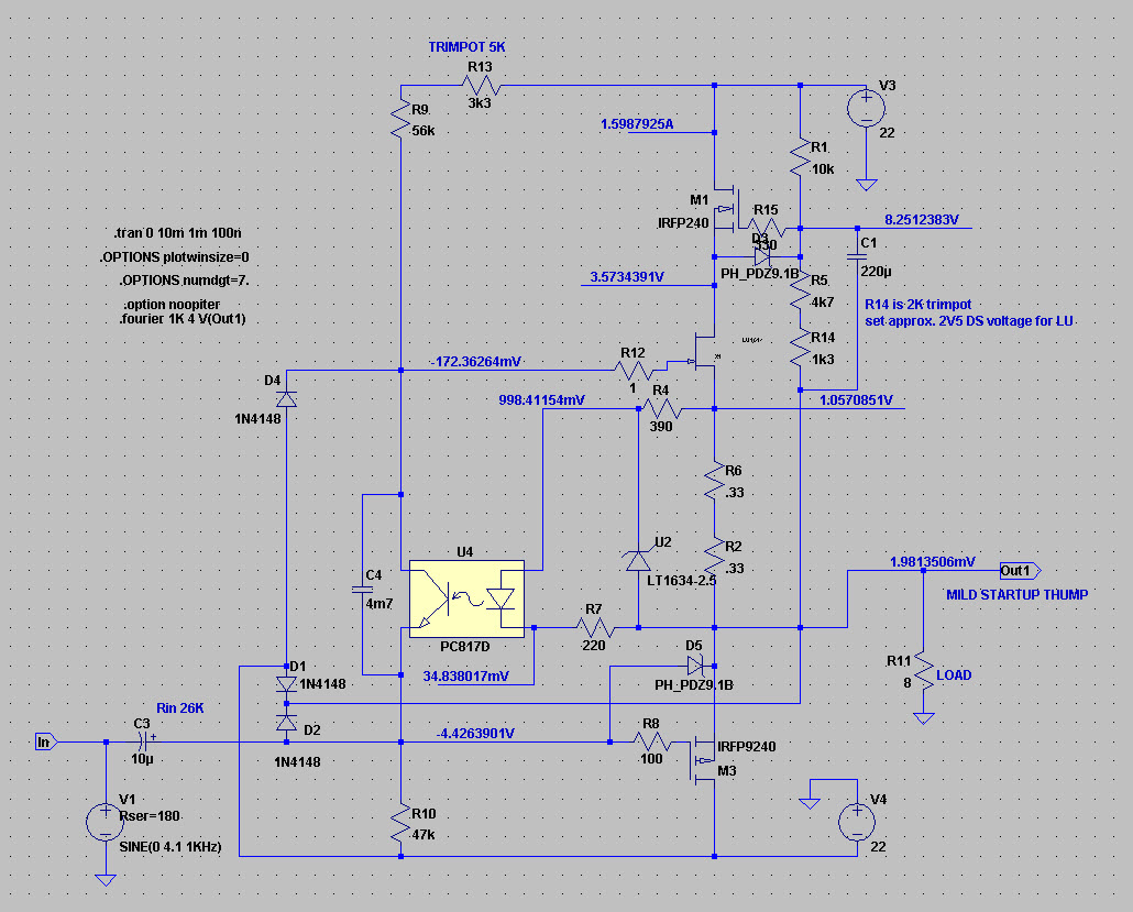

- Babelfish M25
-SEF/Babelfish M2 , practically two (minimally different) amps on same pcb - SEF being my iteration of M2 with Schade-d lower mosfet ........ of which I really don't know where last iteration of schematic is , so I'm enclosing it here ; pcbs to arrive next week , when I'm going to open dedicated thread at present everything ; Babelfish M2 being - well , plain M2 with few twists of minor importance - 2SK2145BL input buffer cascoded , 3(4) options for input xformer
- will also try soon , on same SEF/BM2 pcbs , iteration with working title SUFI-SIT - with THF51-S up and plain mosfet down ; fingers crossed for that one , too 🙂
-LuDEF amp ....... what else than cascoded LU1014 up , and mosfet down
Babelfish XA25 , dunno when I'm going to squeeze that one on T-Bed 🙂
except BXA25 , all of these are somewhere back in the thread , but lets just repeat SEF amps schm this time

Here is what I was thinking:
Use bias tricks, such as in DEF-Amp post #43 DEF Amp with one or more (IXYS) depletion mode NFETs over a single IXYS enhancement-mode hockey-puck PFET. I do not know how well the temperature drifts would cancel. Possibly also use Shade feedback with the NFET(s). If multiple NFETs are required, the each NFET can have a Vgs offset adjustment as in post #43.

anyway - Mighty ZM unable to find any other way to mimic Wakoo current distribution , parts are having in original Pa's DEFiSIT , and exactly that (current distribution) is most important part of behavior I strive for
what I did show is what I was able to concoct with parts I have (or will have) on hand
chasing another (one or more ) preputium made of parts is outa question
I guess I will order some IXYS depletion mode parts and give it a try using an XA25 style FE with feedback around the FE only.
Do you have any SPICE models for Papa-SIT or any of the other SITs? I would like to use them for comparative simulations against Shade FB around various NFETs, such as the IXYS depletion-mode FETs.
just take a look at our Mr. MR's site
he's , like you , number friendly mind and exploiting that .... while I'm more back of napkin scribbling type ....... so I got them from there
From post #213 http://www.diyaudio.com/forums/pass-labs/314822-greedy-boy-defisit-papas-koans-post5288307.html:
Dunno Pa , just trying to translate what sim is showing 🙂

"Trust but Verify". I do not trust the Papa-SIT SPICE models without verification.
'In vivo' measurement of the current waveform through the Papa-SIT would be tricky without any sense resistor directly on the Papa-SIT source or drain connections.
A somewhat complicated differential measurement the output voltage V(out) and the voltage on the IRFP9240 source pin Vs(PFET) would give the following expression for I(SIT):
I(SIT) = I(Out)+Is(PFET)
= V(out)/Rload + (V(out)-Vs(PFET))/Rs
where Rs is the source resistor on the IRFP9240.
Such a waveform measurement would impractical.
