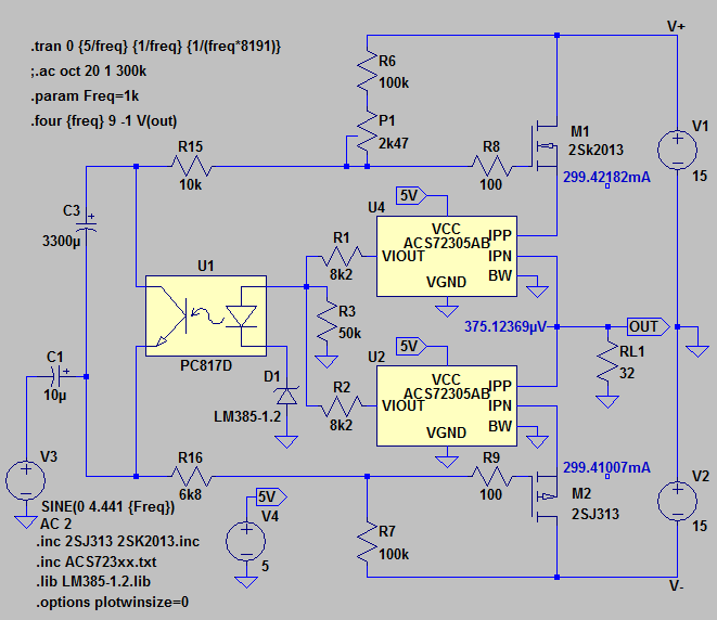

Hockey pucks , being sooooo wild beasts , simply can't be tamed with current sensing Hall IC , without resorting to additional amplification stage (in bias servo) ...
Your finding gave rise to an improvement idea. The first iteration is not so sensitive because the 2.5 V + 400 mV/A signal from Hall chip is attenuated to < 48 % by a resistor network. There is an option that increase effective signal to > 86% by DC shifting the opto using a voltage reference chip like the LM385-1.2 as attached. However, usability with the pucks still need further investigation.

per sims , comparison with (so called :rofl: ) final Babelfish M25 sim , elevating optooupler for 1V25 , then increasing both Hall output resistors and gate-rail resistors ...... result is few times worst Iq stability ....... both in temp domain and rails change domain
so , gut ...... told me that Babelfish XA25 will stay with current mirrors in bias circuit
Hall chips - they simply demand additional gain stage , between them and opto(s)
in any case ..... idea was worth checking ; we are not in state Mu , in terms of scientific process (few steps back , few steps forth , one step back , few steps forth )

...... result is few times worst Iq stability ....... both in temp domain and rails change domain ......
Yes, wrong approach. AC component became prominent while stable Iq needs the DC average.:D
Hall chips - they simply demand additional gain stage , between them and opto(s)...
Or some kind of LPF to attenuate the AC component.:)

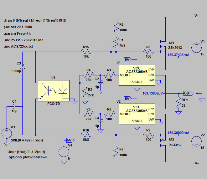

  • ZM M2SEF Hall Effect HPA R3.asc
The change of R18 and R19 from 2k7 to 18k hurt Iq stability vs change of Vcc. Adjusting Iq by loading with a 4k7 improves stability a bit. The addition of LPF improves dynamic Iq stability on asymmetric design like the attached SEF.
