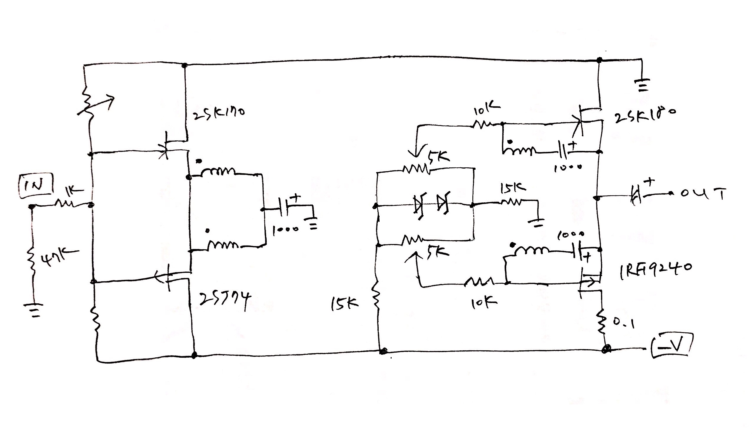

I believe I'll squeeze them in (last) schmtc with 2SK180 , already posted here in thread ;
that will go on upcoming SEF/Babelfish M2 pcbs
two criteria are fulfilled :
- it is SIT , so fast as Sparrow's fart
- with that schematic , current distribution between parts is same Wakooo as in Papa's DEFiSIT - mosfet doing all the work , while SIT acting as error correction , or whatever correction ......... maybe Wakoo Correction :rofl:
only jumping in to help when mosfet is outa breath

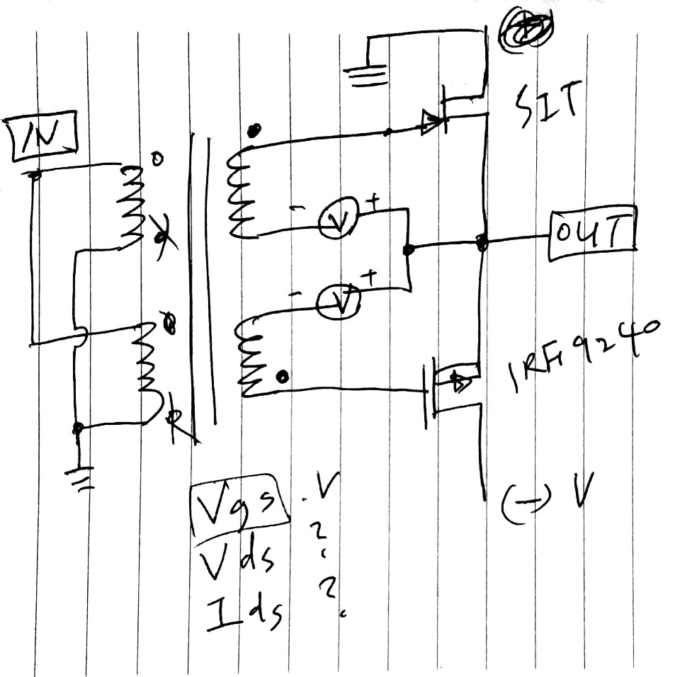

Can you call this a DEFiSIT ?
Maybe we can brodean the usable SITs this way?
Please let me know why or why not this would work... 🙂🙂 I am a dumb builder..

with present state of 2 cells (multitasking in several planes, besides just finished late lunch , so cells starved more than usual) , I should say - why not
be careful how to manage these two voltage sources , noiseless is a must
observe F6 for few tricks , combined with M2 and DEFiSIT , of course
few clever tricks also buried in Antoinel's threads

I think the circuit can make a sound anyhow.. But is this the DEFiSIT, with those advantages that Nelson described? 😕
1. Single-ended sound with such harmonics
2. Doubled output due to push-pull
3. Increased damping
Cheers
well , it could be kind of "rearranging of standard" , as in Jazz music .....
however , without spending some time with simulations , I can't predict exact behavior of these wakoo combinations
if you go back , you'll see graphs I took from simulations , showing insane current distribution between active parts - up to the clipping , mosfet (lower part) is doing extra heavy work , while SIT is actually working against the mosfet ...... as sort of ( who knows , is it?) naturally born phenomena - error correction or what :rofl: ....... anti-error correction
anyway , with xformers involved , where gates aren't tied tightly as in DEFiSIT , I believe we will not have that sort of current distribution ......

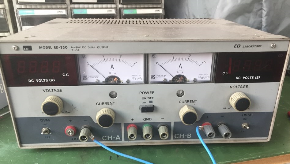

You are not promising but you don't have to. I appreciate it enough!! 🙂
I have this Dual PSU 30V 3A CC CV and I think this is safe tool to try the circuit.
Cheers
