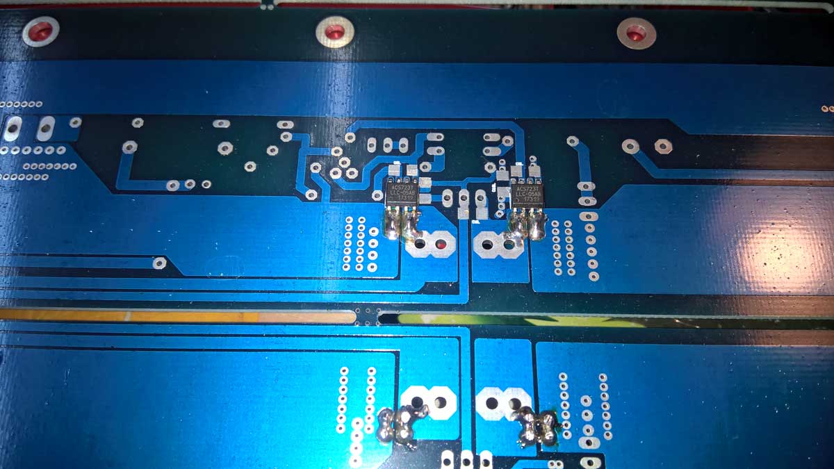

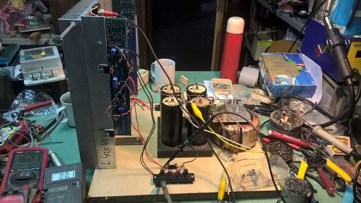

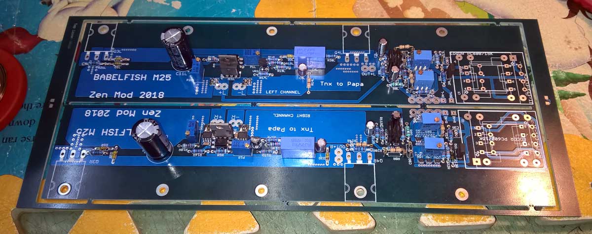

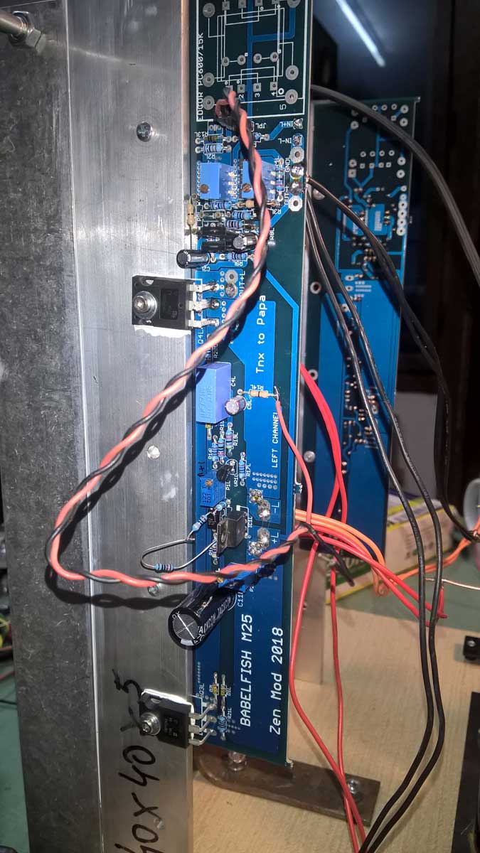

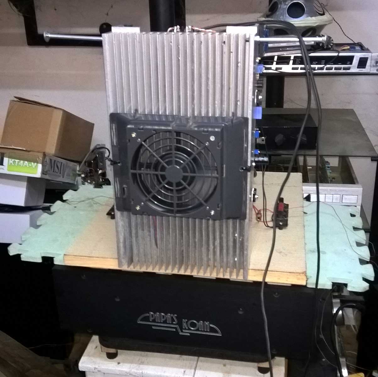

Honney , I created The Monster!
Well , it works .
It's really easy to work on newly made test bed (T-Bed , it deserves own name) ...
except one tiny change (value of resistor in parallel with opto-diode) and surprising fact that is not normal inserting mosfets on pcb , while PSU is fully powered on (damn phone distraction)
, really everything is as prescribed on back of (LTSpice) napkin 😀
'morrow mounting Edcors (both Jensen and Cinemag pinouts present on pcb ), wiring another channel ,mounting lazy 12cm fan on heatsink face ....... then struggle with EMU1212 setting for FFT measurements
maybe I will enjoy in listening few days , then measurements

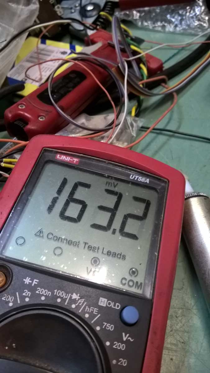

Iq is rock-on stable during extended power on-of cycling , DC offset too
Iq monitored on 0R11 , part of CRC ........

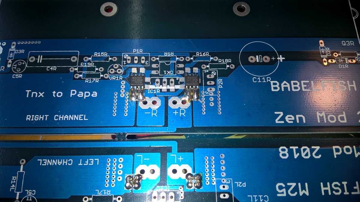

however , as zillion man and machine hours sez - I rejected Hall chips sensing for pucks - there is simply not enough gain in bias servo , when made with hall chips ditto to optocoupler(s) , so I resorted to current mirror scheme (my best shot posted in Beats thread)
yeah , I believe it is possible making bstrd of M2 and Beast - buffer+autoformer feeding adequately biased pucks ....... but somehow ugly capacitances of pucks are rearing a head ........ is it buffer+autoformer too weak , that's question only bench test can answer
btw. there are just two hall sensor chips - one in each rail

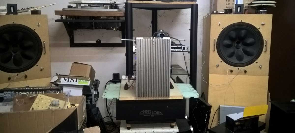

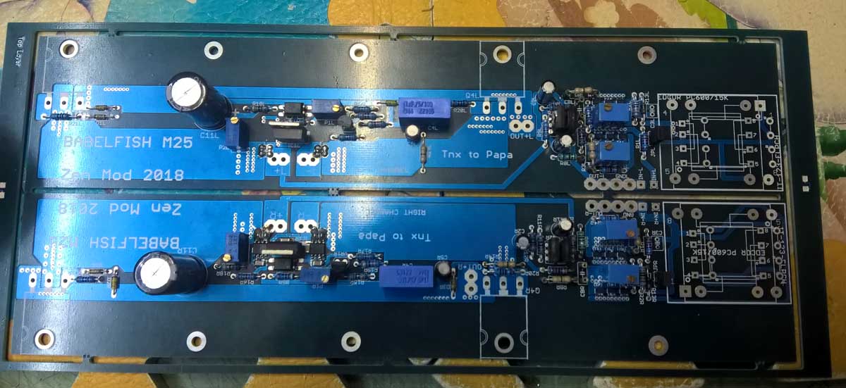

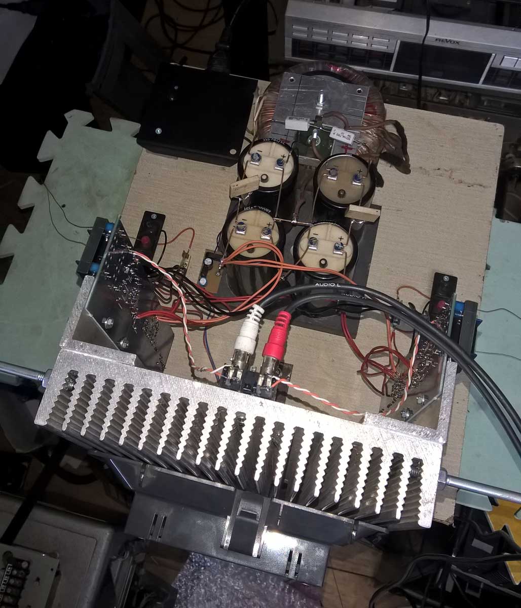

it works, and it sounds reallllly good
took just one fast and dirty phone pic
even connected few days ago finished final iteration specimen of Iron Pumpkin SE , but didn't took that picture
was tired , wasted at least 3 hours of work trying to solve ookup with right channel - replaced two Hall chips , opto ......... scratched my head from all possible and impossible directions ....... only to found one bloody 1N4148 , taken from ancient box (never again!!!) had wrongly labeled stripe
anyway , life is good ;
two good Dreks finally made/confirmed , in 3 days
