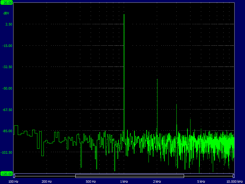

I think k2 over k3 is too heavy, mostly Nelson prefers mostly k2 12dB higher k3.
What is your impression of the sound?

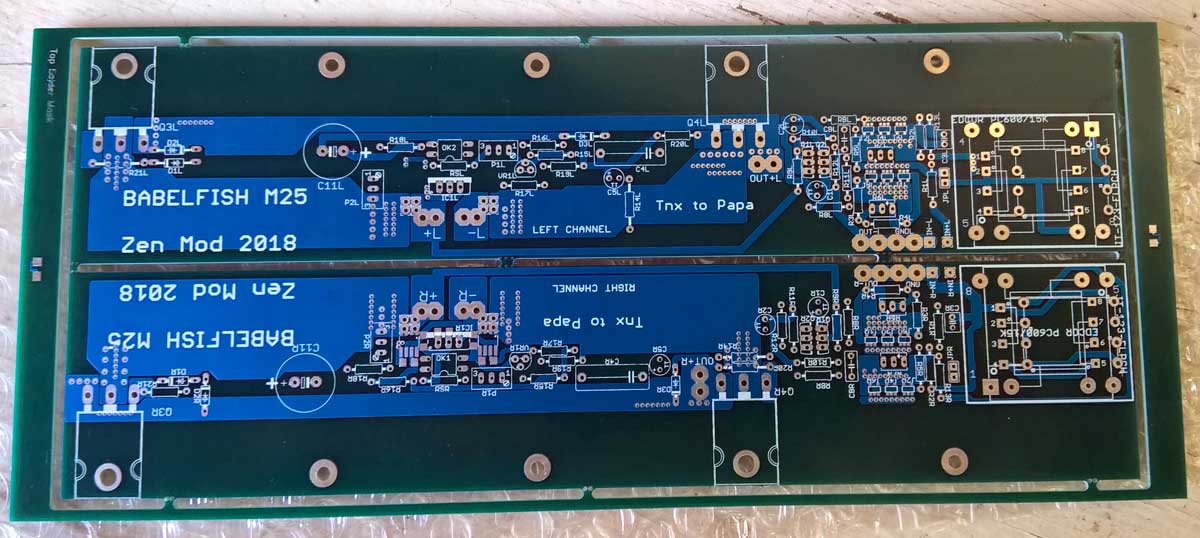

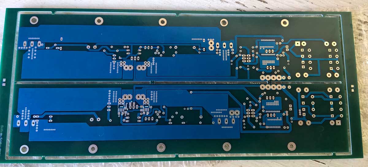

A hybrid between M2 and SIT with some PP, current driving characteristics. That's gotta be tasty. Hope they have one at the next California Audio Show to hear, although the stuff is usually Pass Labs rather than First Watt. The Zen audio guys usually bring the SIT amps.
Hockey pucks , being sooooo wild beasts , simply can't be tamed with current sensing Hall IC , without resorting to additional amplification stage (in bias servo) ;
for them , I opted for different solution , shown in F4 Beast.... thread
this one is for exploring same approach - no source resistors , and in that arrangement even regular Papamosfets (240/9240) are pretty wild .....
we'll see (confirm) in a week or so
- Most Greedy Boy, of them all... or (there is no) DEFiSIT of Papa's Koans
