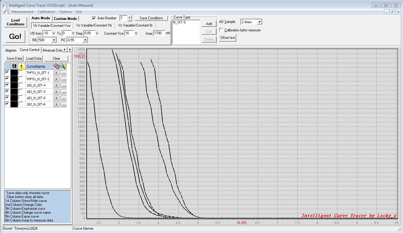

Hi cwtim, please switch in your curvetracer picture from the SK180 the "load conditions" button for me so I can see the real conditions you used.
The conditions shown are possible not the ones necessary for a measurement.
Please for me, I want to measure some parts from my basement too.....
Thanks generg, please ignore the conditions you saw on the screenshot. My tracer was dead since a long time, and I only used the GUI client to open the data file for viewing the measurements before.
Those are Id_vs_Vgs curves with a fixed Vds of 20V. I had lots of 2SK180 at some point (mostly sold now), so those measurements were just a quick way to do coarse Vp matching.

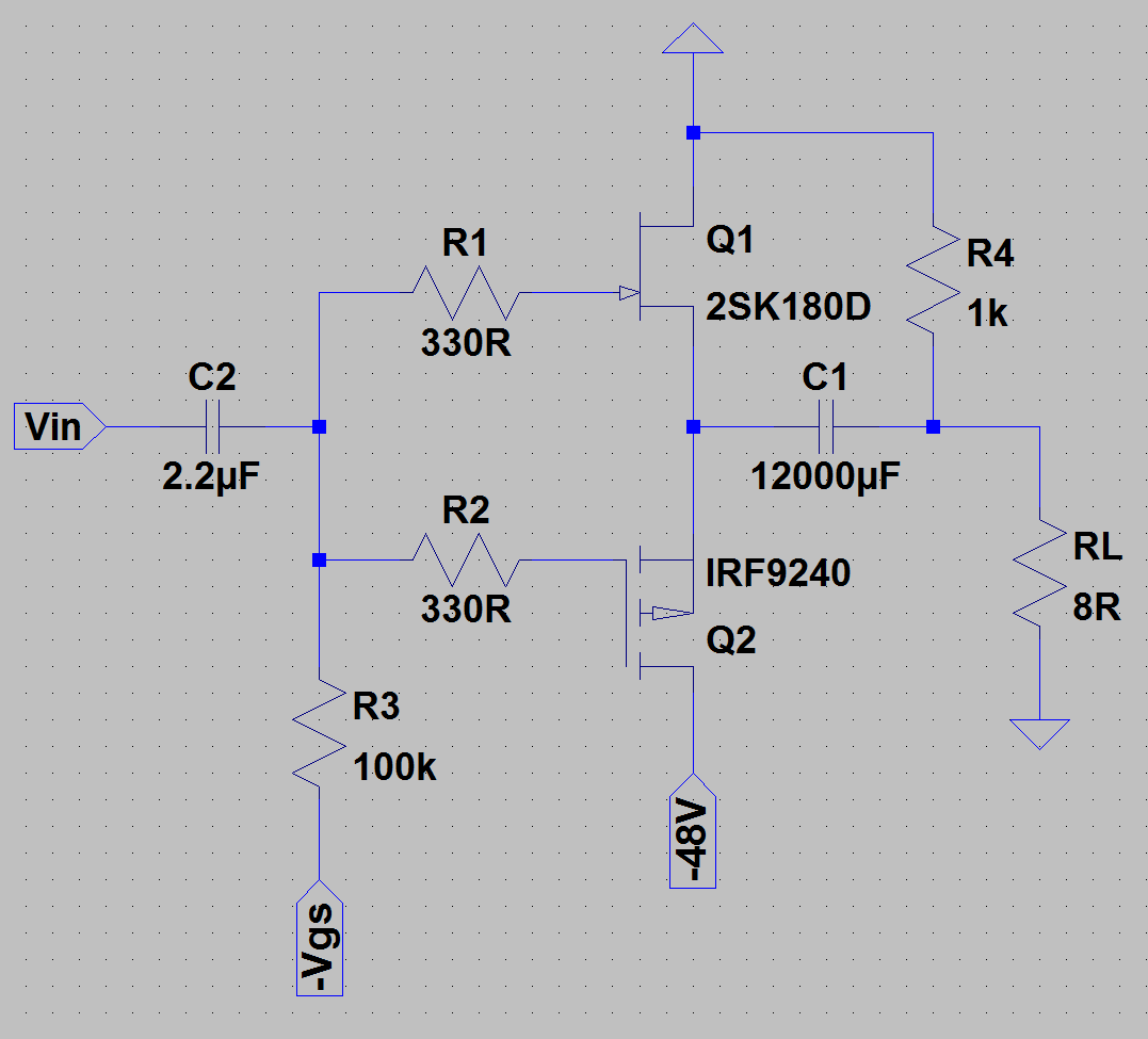

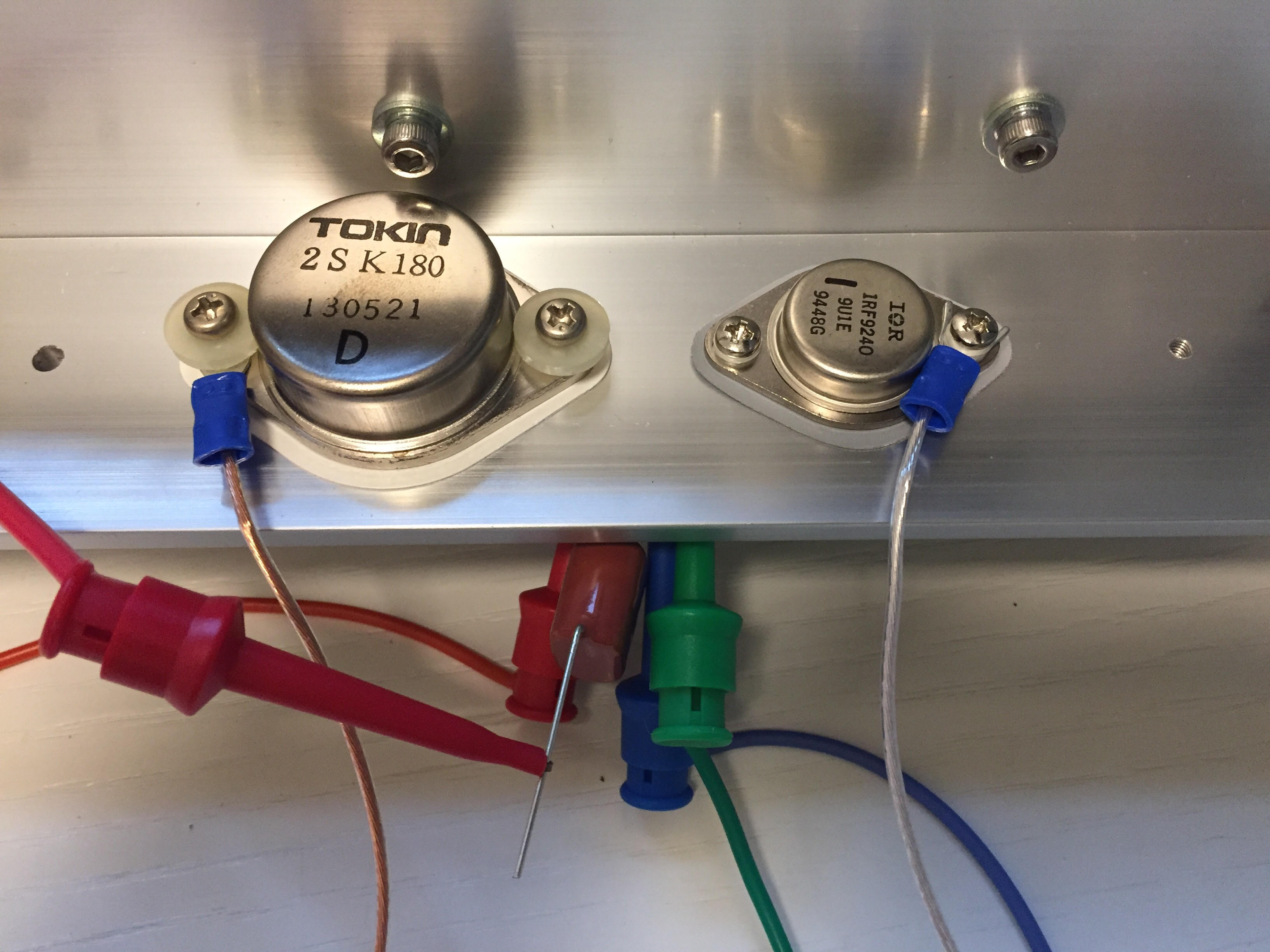

The DEFiSIT output stage works 😀, and it's fun to watch as things just adjust themselves automatically to stablize, and no bias circuit is required (OK, there is still a 100k resistor for the Vgs, plus 2 gate stopper resistors)
I use 2SK180D+IRF9240, put them across a -48V single ended power supply, and the bias is mostly defined by the IRF9240, while the Vds across the 2SK180D will change to match the current of the IRF9240.
The IRF9240 gives Id of 1.3A @Vgs=-3.9V, and at that Vgs the 2SK180D needs about 27V Vds to give 1.3A, leaving 21V to the IRF9240, hence output cap is definitely required.

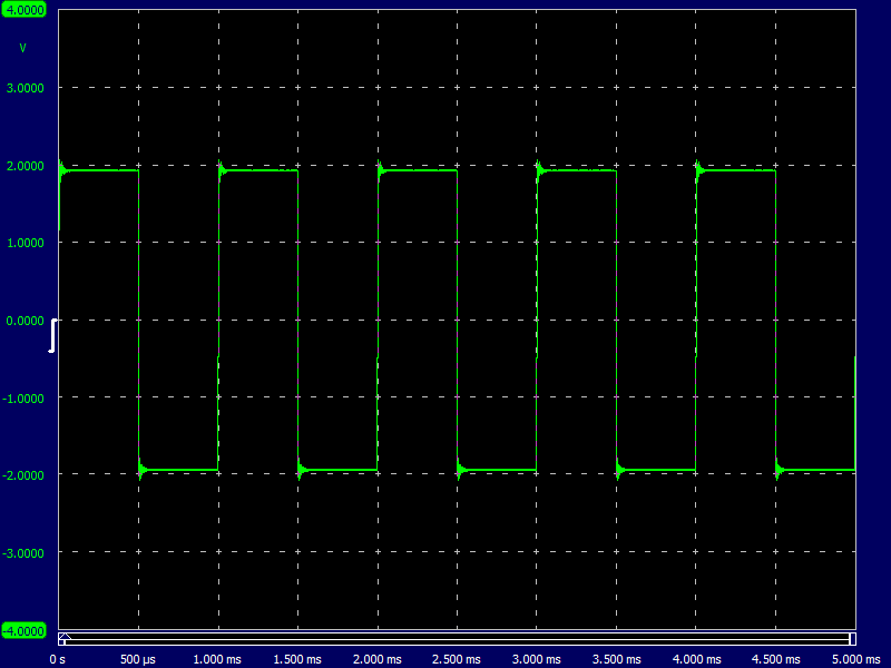

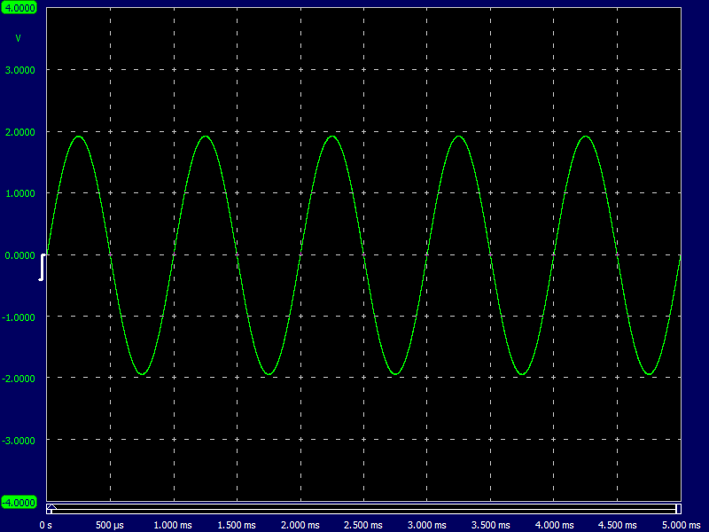

The sine output looks pretty clean, but I got some ringing with square wave, probably the 330R gate stoppers needs to be higher.

I believe the best would be those 2SK180D that gives 1.3A @-4V Vgs and 23V Vds, matching well the IRF9240, and consume less heat.

it seems that the two THF51 in the middle are usable.
I estimate 3-3.2V @1.5A.
It seems you used a Vds of 16V for those measurements, and |Vgs| to give 1.5A will increase when you raise Vds to 20-ish range. For the 2SK180 I used, raising Vds by 7V actually changed the Vgs by 0.7V.
I think your THF51s will match well with 9240.
Yes the problem was that the Vgs in the curve tracer is stolen from the available max. Voltage of the device.
So the upper range of the curves got another slope than the beginning.
Reducing from 20 to 16V made the slope more equal.
I will drive the circuit with 35V, so I thought 16V for the SIT is near the half.

In that case the 2 devices with higher Vgs are best.
But then, there is a way described here, which overcomes the differences and offer much more freedom.
By the way, when my Lockyz was still alive, I often controlled the Vgs via a 9V battery and 10k pot, this will leave much more voltage headroom for the measurements.
