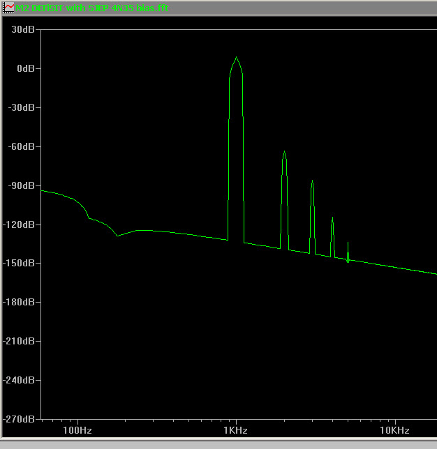

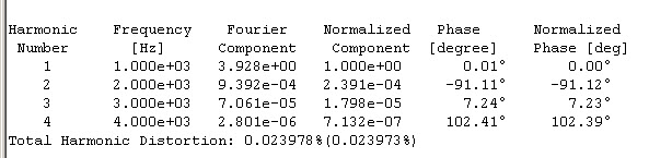

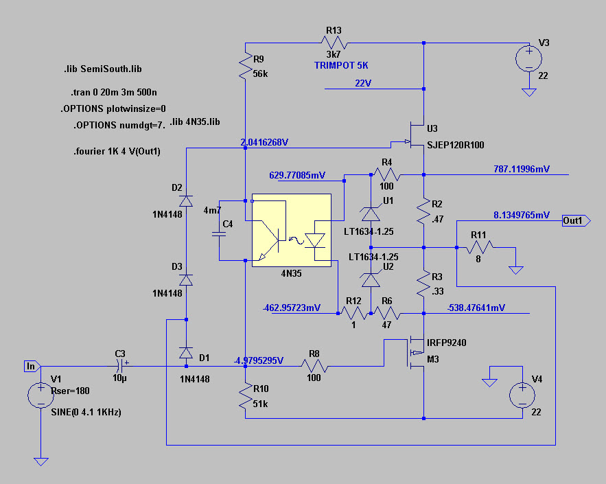

as promised - SJEP , so no DEF but EEF
:rofl:
SEF
this one goes in prototype
Zen Mod, I experimented with your SEF circuit. I left R7 at 220E as in original M2. R1 & R2 was made by a string of 0.18E X 3, 5watt each. But they got too hot in just a few minutes.
I couldn't get offset below 4 volts. Hence, used a 4700uF cap to connect the speaker.
Sound was fuller, more organic, forward and airy. But the liquid character of M2 was sacrificed.
Comments.

any of these amps made with DEFiSIT as role model , will have greater THD than M2 , so it is logical to sound less clean , erring on sweet side
regarding values in any of shown sim schematics , they're exactly that - simulations , so some value tweaking in vivo is inevitable
setting correct Iq ( look at Pd per device - 35 to 40W) and offset is trivial thing , done in 20min or so
so , fear no more but no less , you'll need to wait for (slow) Mighty Moi , to show in vivo values , in case that you can't fix them by your self

Thank you Zen Mod for your response. I could try setting offset etc. What is the dissipation in R1, R2 & what wattage would be appropriate? Thanks.
everything is on schematic
top of R1 is 1.01V , bottom of R2 is 3.8mV
so , I=U/R
1.01/(2x0R27)= 1A87
dissipation in resistor P=I^2 x R
P=1A87^2 x 0R27=940mW
3W resistor will do
so , you need to have one voltmeter across any of 0R27 to observe and set Iq , and second voltmeter across output to observe and set offset
write here what your results are and I can tell more precise what to do

Zen Mod, I get your point about offset - going back to schematic in post 264, if Trimpot R12 doesn't get rid of offset, depending on polarity, R6/R13 need to be resized.
But what controls Iq, other than R1, R2?
voltage sag across two 0R26 resistors is feeding opto LED , opto LED is controlling "openess" of opto BJT
current through two 0R27 resistors tends to rise ,LED shines brighter , BJT is more open , more current through resistors up and bellow ,more voltage across them , thus squeezing mosfet gates closer ........ closing them for current
simple , isn't it ?
