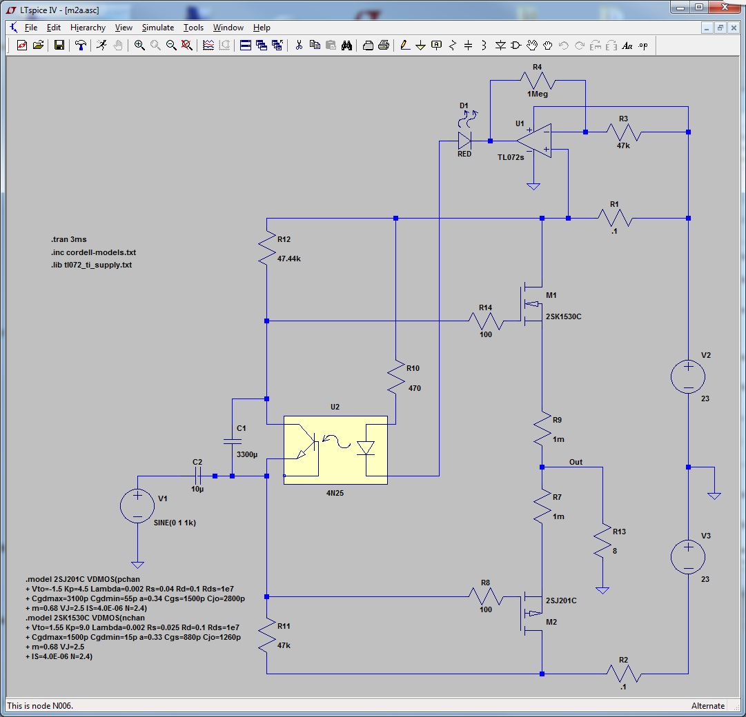

Re current sensing: if you are concerned about Iq through an SOIC chip can I suggest some low tech approach?
OpAmp that an handle positive rail input to sense the current from your CRC.
Please excuse the dirty trick with the red LED, but TL071 output doesn't go to the rail. I am sure there is better opamps for this task.

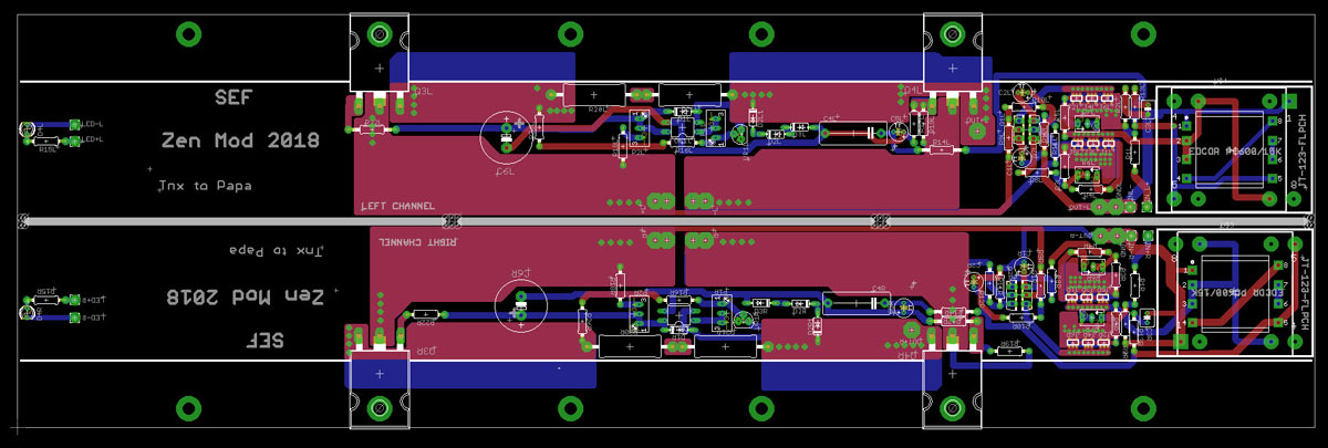

It just cross my mind that the Hall chip can easily be made to serve double duty to overcurrent protection scheme you may want to incorporate for that particular babelfish project.I made my own layout solution , ...
yup , thought of that ........ already existing pair of rail chips , then separate summing net to , say , triac for shutting gates together .......
exact values of summing resistor net needs to be tuned in vivo , due to lalala behavior of triacs
anyway , not overly puzzled with that , I'm not going to sell that amp to unknown fool ,invoking protection tripping (as Papa does) ........ I know that this fool is little more careful , so mains fuse will do just nicely
ZM ... why did you decide not to use the 0.1r in rails way ? My Guess was that papa use that rail resistor method in xa25 ... not that we have to necessarily copy his approach but juts curious ...
I know which value Papa is using (can't tell 🙂 )
I decided to use 0R1 as biggest I can cope mentally with (when you know a smudge , it's normal to fixate on irrelevant things , like value of power resistor in rail , Shinkoh , Obligato , Dale nonmagnetic etc. ) and practically smallest - to avoid constructing MC prepre as gain stage for servo circuit ........ which in this case bias mech. really is - servo)
however , I'm going to pursue those Hall chips found by indra not as something better than I already have , but as something worth pursuing
hehe , not (as used to be said) - pursue because of pursue itself but because of simple joy in pursuit
same drek , different explanation
For that scheme, easier to use a High-Side Current Sense Amplifier like the Si8540, but not as versatile as Hall chip.... I am sure there is better ...
