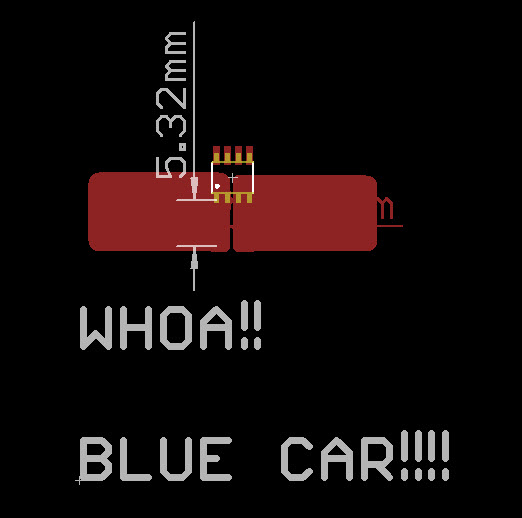

I asked not because I'm scared of soldering little buggers , but because I would sleep better knowing that entire amp current is not going through two tiny legs (pair plus pair) .....hoping that there is package with little less tiny legs
doesn't matter how much adapter looks nice and useful (however , nothing saving you from actually soldering little critter) , traces at adapter are too tiny for currents involved, so finally just exaggerating level of nightmares

For the SOIC8, solder paste really helps as shown on youtube vid here. A bit easier, less chance for a short, the excess flux actually flows the solder to the pads. A couple of short pieces of solid copper wires can easily be added easily enough to avoid nightmares.

looking at specs , it seems way too crude for our purpose , already found ACS723/10A being in right area for our needs
additional 1.0mm wires - already tinkered of ... and they seems mandatory
will battle with SOIC8

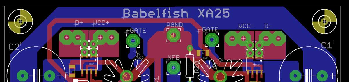

Surprise !!! 🙂 No battle with this Arduino current sensor module. Sensitivity is only 185mV/A though.... will battle with SOIC8
OK - goooooooooood for experiments
but , for my use , will make my pcb arrangement , integrated on amp pcb

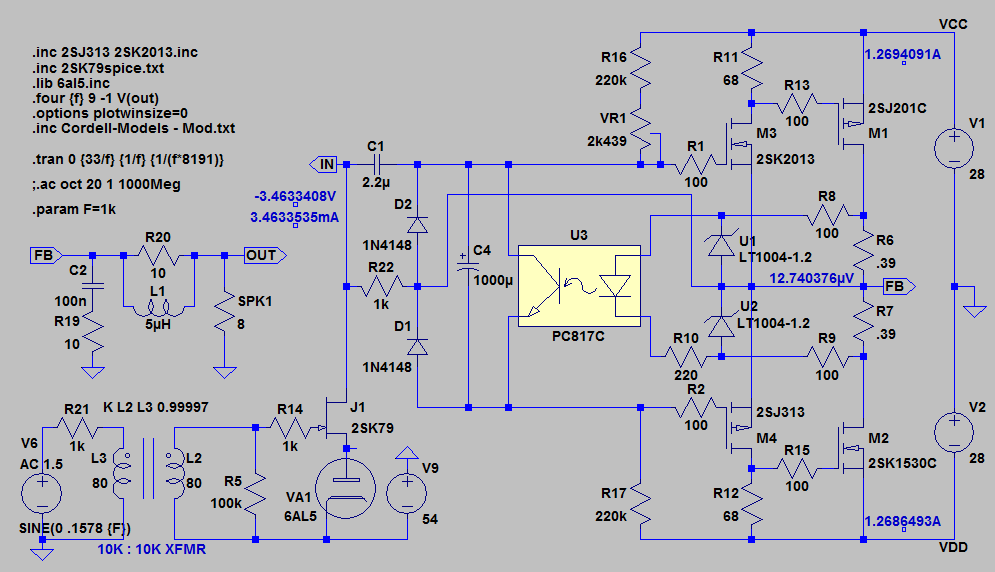

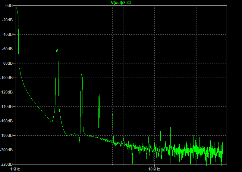

Papa's opto bias is really crazy amazing. I'd like to share a sim of a CFP MOS output stage with an alternative no source degeneration scheme with DF ~140. When higher DF is desired, an Opto & Hall chip combo can be chosen instead.
However, it is not easy to see the merit of the circuit in LTspice. 4H and above distortion figures reported in log file are useless being buried under simulation noise floor.
The trick is to choose Hann or Blackman "windowing function" on FFT view to clean up noise floor and give more meaningful figures. At 1W, the circuit exhibit monotonic distortion spectra with 3H and higher distortion figures rivaling those of the very best conventional DHT SE tube amps, at least in simulation. The 2SK79 can be replaced by a 6DJ8 with appropriate adjustment of V9 if desired.
