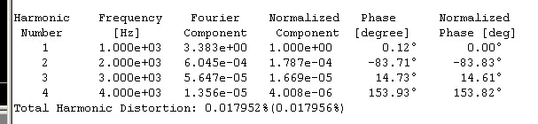

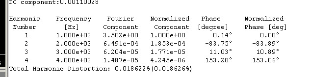

Since you have output capacitor, you have 2 easy change that may give different sound signature.
At current output point of #170 (source of M1) and your bias, my sim show negative ~170 deg H2. You may :
1. move connection point of output capacitor to source of M2 and listen. Sim show positive ~100 deg H2 if you do this. Presentation will be more forward.
2. then reverse speaker connection and listen. Sim show negative ~80 deg H2 if you do this. Presentation will move back.
Still too shouty? Do you have the R5 (10k) - C1 (680p) zobel at the input like original M2? You may want to add them if you do not and still think the presentation is too shouty.
Have fun.
Phase ? what's some phase between friends 🙂

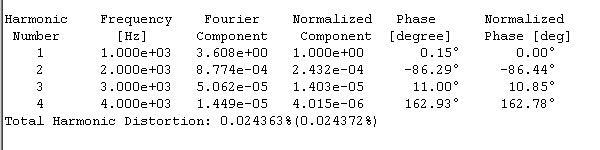

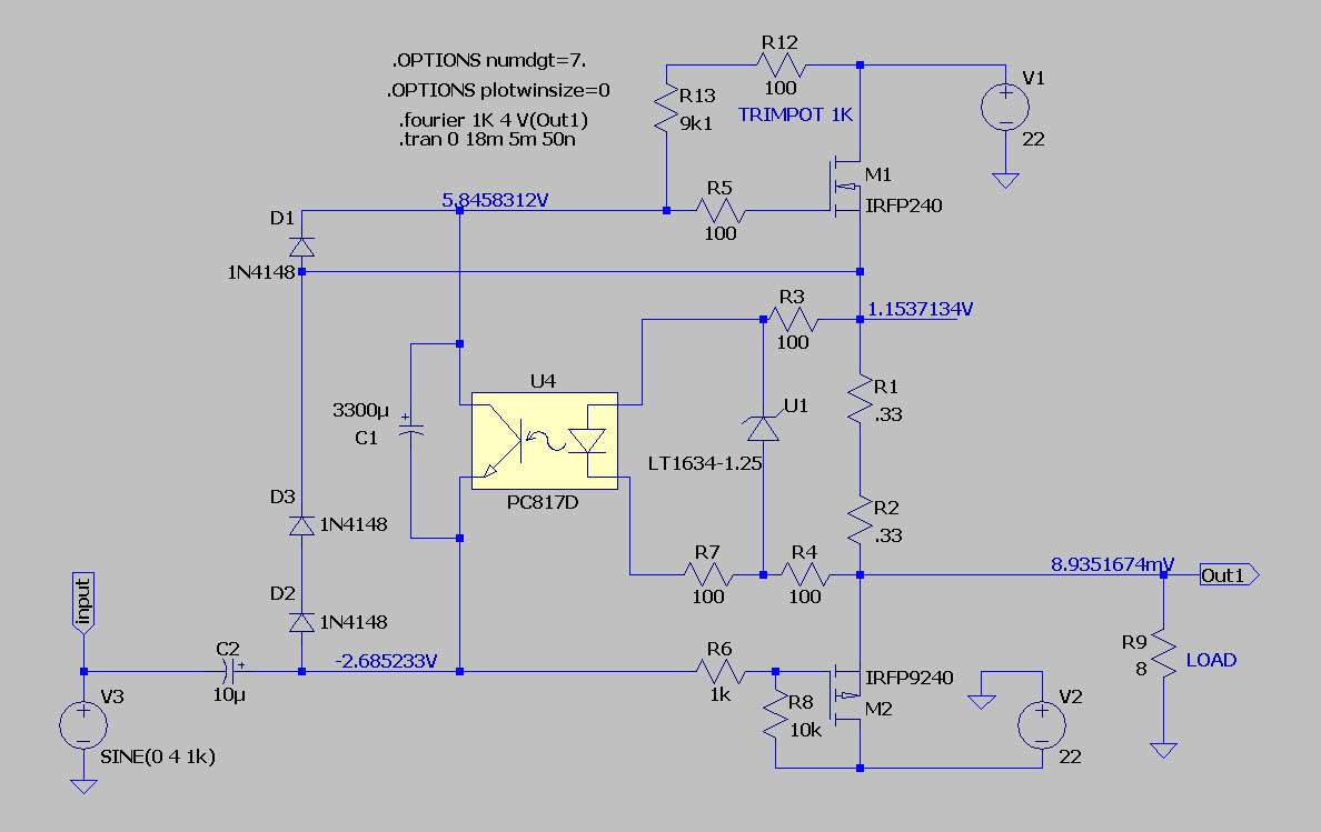

ya want different phase ?
easy - just turn upside down .... price is more THD , in numbers

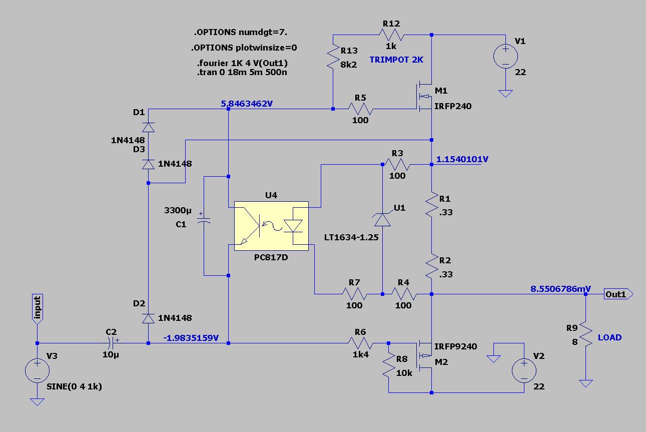

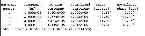

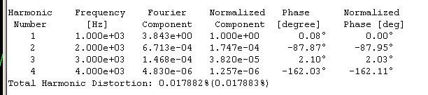

change to prescribed opto
source resistance is veeeery important
and try latest one (Schade down) with gate resistor up to 1K4
also , take care of properly taken output node
this one is on par with original M2 , at least according to sim
then , why change :rofl:
disclaimer - arrangement of 3 1N4148 still needs some rethinking .......

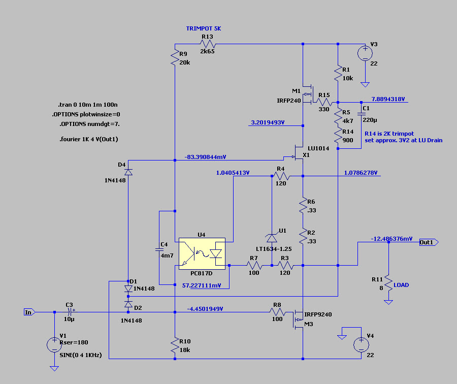

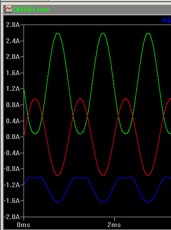

interesting thing , if you observe currents in load and outputs separately - uper mosfet is working against load and lower mosfet ....... something as lower mosfet is error correction device :devily:
that said for SEF amp , with Schade connection on lower mosfet ;
same applies for Papa's DEFiSIT ....... IRFP9240 down is doing heavy work , practically working "against" load and SIT in upper half , so SIT practically stealing some funny strange Voodoo amount of current
Papa , care to comment , anything ........?

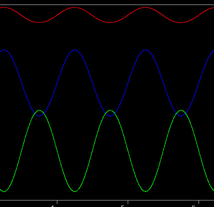

attached screenshot of currents in SEF amp , ref. to post #193 :
blue - current through load
green - current through upper mosfet
red - current though Schade connected mosfet
of course , all hell breaks loose when approaching highest amplitudes ...... I mean , I can't stop laughing , just looking at currents through mosfets and resulting current through load

can you do the same pic for M2 config for comparison, pls?
nothing to write home about - each mosfet having exactly 50% of current swing , and they're summing through load ; OK - small difference , resulting from difference in their xconductance , but practically that's that
