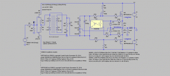

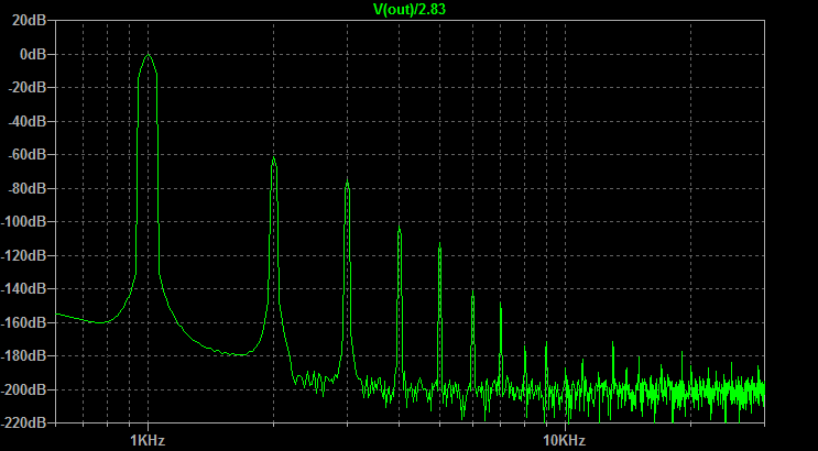

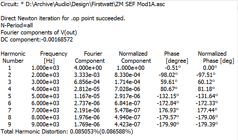

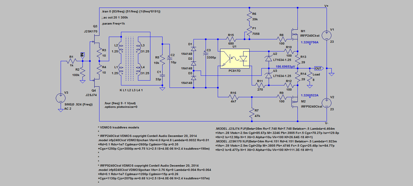

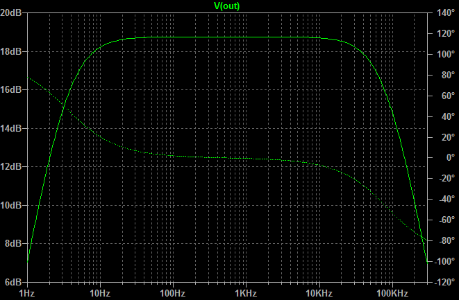

:up: to ZM. I played a bit with #133 idea and got really good result. Negative H2 phase when gain of the N mosfet is higher than the P mosfet (R15 < R16). This idea made harmonic adjustment (similar to P3 in F5) available to M2 output stage. Comments?

It does not. The Schade connection is still there, as the same amount of
current flows through that resistor in either mode.
Of course, the effect is suppressed by all the degeneration offered by
common-drain operation.
