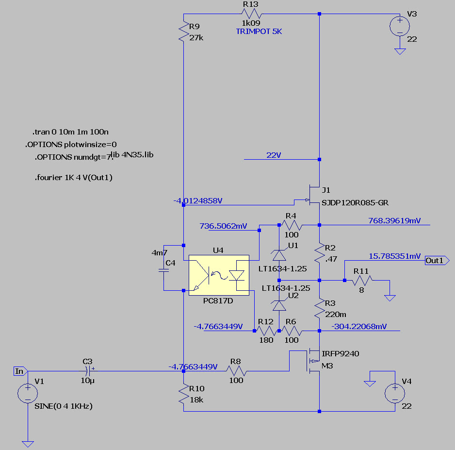

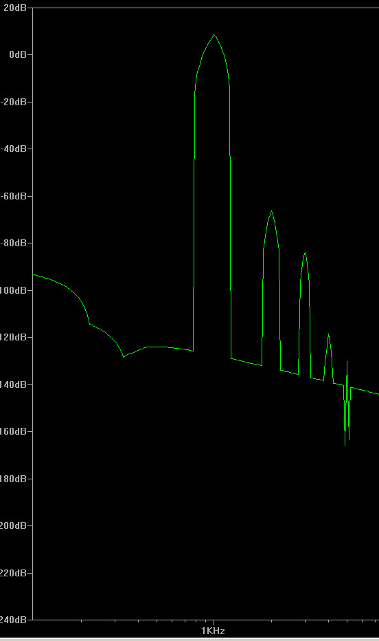

Silly ZM ...... I have it in my LTSpice , imported in JFet library eons ago
so , here it is , with SJDP
it needs speaker delay relay , having startup peak , about 10V in first 50uS
at least according to sim .... worth checking in vivo , with soft start etc.

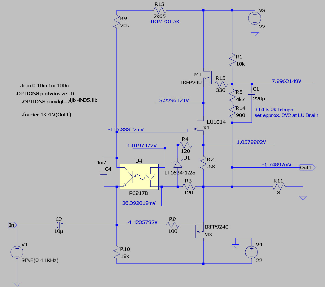

latest iteration of LuDEF sim , much closer to pure DEFiSIT ideal ..... no source degeneration for IRFP9240 , while entire combo consisted of LU. it's source resistor and IRFP240 cascode should be considered as poor man's SIT substitution
hey , it gnawed just right on me ...... one can try even poorer man's SIT Substitution (as fast & furious taste of Real McKay) ..... using verbatim M2 circuit , but connecting upper mosfet with Shade thingie (1K+10K) ........ will try that sim pronto :clown:
mild and slow thump (under 400mV) during startup , most probably even lowered due to action of (commonly used in Papamps) NTC softstart

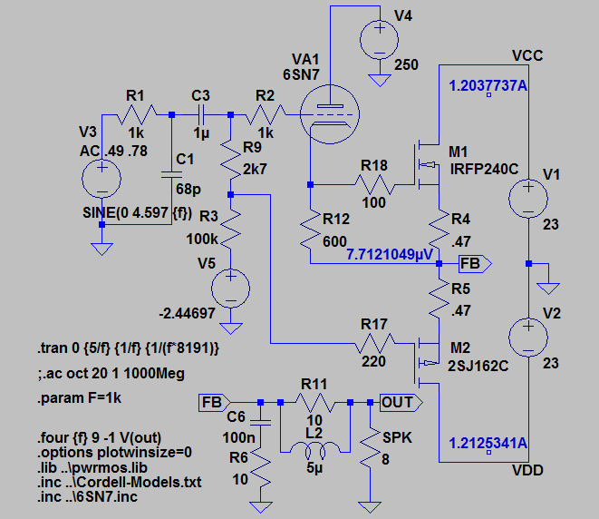

There is no AC signal on the drain of the MOSFET (the drain is grounded AC wise through the PSU) so there can be no feedback that way (nothing to feed back, just a static DC bias conditiion).
The last paragraph on that page speaks only about cathode degeneration as the form of feedback that lowers the distortion and it's irrelevant from the "turn penthode into triode" point of view.
