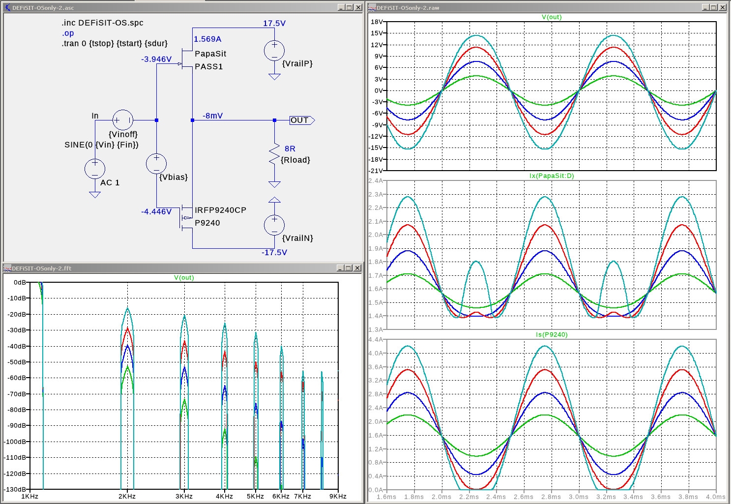

I am also using the MR Papa-SIT SPICE models. It should be noted that they do not include temperature coefficient parameters, thus they will not help to simulate the bias drift with temperature. I am using the Cordell IRFP9240 model since the default model in the LTSpice library has an abnormally high lambda parameter.
Below is a simulation of a maximally simplifier DEFiSIT output stage at 1W, 4W, 9W, and 16W into an 8R load. Note that the PapaSIT drain current Ix(PapaSit😀) waveform begins to become weird at 9W where the output stage is leaving class-A as shown in the IRFP9240 source current Is(P9240) waveform. This might be due to the IRFP9240 transconductance being too high as Papa suggested in a previous post. I will do some experiment with lower values of Kp in the IRFP9240 SPICE model.

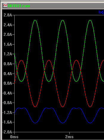

I'm still strongly convinced that sim is OK with that funny current distribution ;
I have simple logical explanation (it's always easy post hoc , isn't it ?) , but too lazy to type , demanding some subtle language battle with conundrum...... for which I'm not enough saturated with coffee right now
later maybe
this circuit is really demanding one to understand and even to simulate.
Sound is already fairly good, but my k2 is too high around 20dB over k3 so at 1W around
0.4% THD
Do you have any P channel MOSFETs with a lower transconductance to try. Alternatively, you can reduce the gm using a resistor divider R1 source to gate, and R2 drive to gate. R1/(R1+R2) will be the gm attenuation factor. This divider will also change the needed bias voltage for the IRFP9240.

observe currents through SIT source , mosfet source and through load
as I posted in #200
(with twice red in text ..... :rofl: )
it is
red - current through 8R load
green - current through mosfet (IRFP9140)
blue - current through PapaSit
