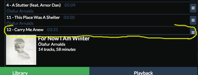

After first hour, I think it's noticeably more responsive (UI).
Could it be or it's just an illusion?
Btw, in the library window, beside of the bug on the artists list, there might be same thing in the tracks list:
Can't scroll down anymore (looks like the last line is missing).
If u notice better response overall in UI its mostly due to the rewritten codebase which has many optimizations and is much easier to work on, however In TR3, I used a new NGINX config that Andreas created as part of Moode 3 project. This might be contributing to improved performance 🙂
The bugs in Library panel are next up on TODO list 🙂
