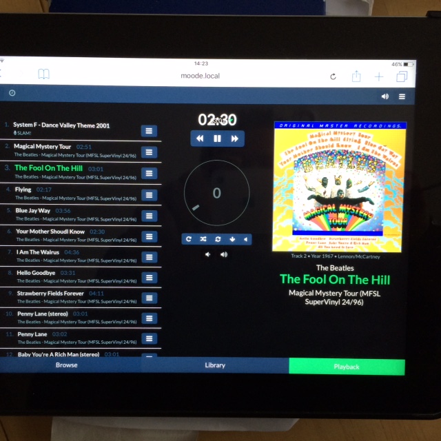

4. When coming back to the "home" screen from settings or other screen most of the time the time circle has gone to circle heaven...
See attached image (IMG_1642.JPG). Needles to say that it will not make that mistake anymore on my iMac when I need it, but this one is a foto of my iPad, same behavior seen on my iPhone.
Tim asked: What resolution is your screen?
1920x1200, 24inch display

Re: your new UI suggestions. I think they are good ideas. There is a way to dynamically change the bootstrap grid layout after hiding the Playlist so that the knobs slide to the left and the cover art and metadata occupy the available space. Eventually I'll get to it 🙂
I noticed on the screen shot that the UI is not running as an IOS Home Screen app. This might be causing the layout issues.
To add Moode as a Home Screen app:
(1) Open Moode in Safari
(2) Press button that looks like an open square with arrow sticking out the top
(3) Press the "Add to Home Screen" button
(4) An app icon will be added to the Home screen, probably on page 2 or 3
Launch Moode from the Home Screen app 🙂
