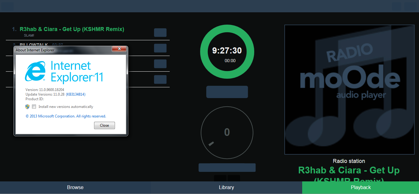

1. On IE 11, running on windows 7 I mis all buttons (the area where the buttons should be present is working as the actual button) see Moode on old IE attachment

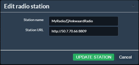

2. I have my own save Radio stations in a subfolder in the MoOde radiofolder. Works great, they are being indexed but i cannot save changes to the station (neither name nor hyperlink). Maybe that is because the save routine has no knowledge how to deal with the subfolder in the name? (Just wondered while writing this what would happen if I delete the folder name part, one moment...ahhhh, just is I expected, it is then being saved in the main folder, not OK then 🙁 ) See Moode problem renaming attachment

I'm not able to repro the UI glitches using IE11 on Win7. See attached screenshot.
The UI for radio station maintenance assumes the station pls files are stored in /var/lib/mpd/music/RADIO folder. It could be enhanced to support arbitrary sub folders. I'll investigate to see how much of a work effort that might be 🙂
You can still use subfolders by just maintaining them manually via the RADIO samba share.

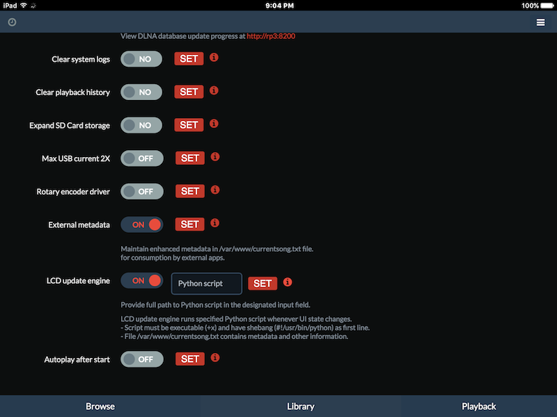

External metadata generation is now optional in 2.5. There is really no need to generate it unless its actually being used for example by the LCD updater or some other app.
If LCD updater is turned on then external metadata is automatically turned on.
This is part of finishing up the bugfix for issue: "external metadata file /var/www/currentsong.txt file not being updated after each song change".
Tim

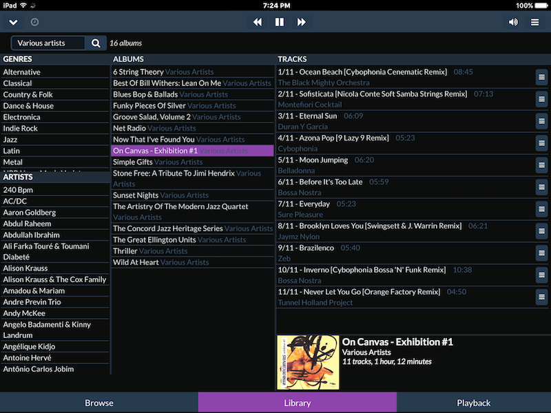

Hi Tim,

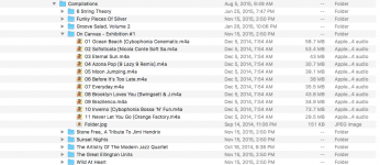

I was referring to the track ordering in the playlist view. I.e. the playlist that is created with the "Clear/Play" command in the Library tab.
The track ordering in the Library tab itself is correct.
I think you can easily get this issue when comparing track ordering between tracks in the album in Library tab and the playlist that is created for "Various Artists" albums.

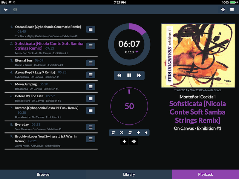

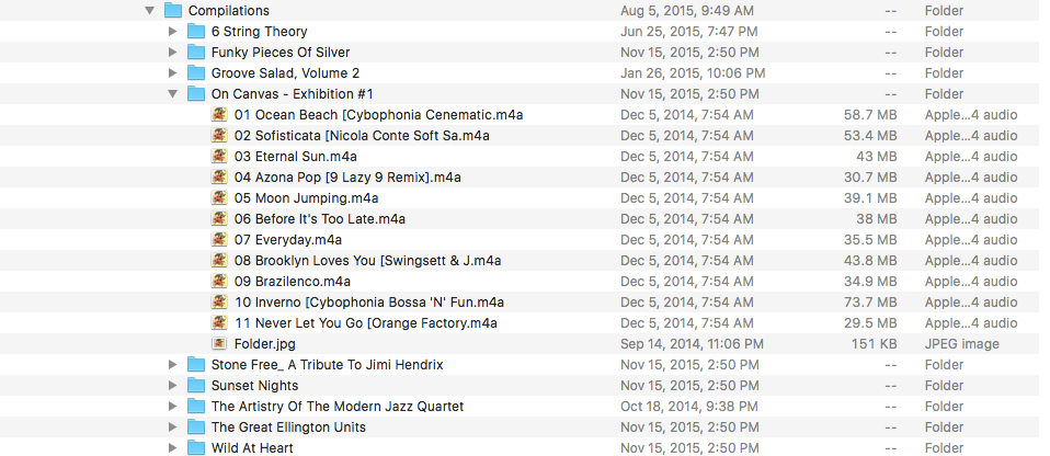

I'm unable to repro the track order issue. Screen shots show Lib panel with a compilation album selected, Playlist after Clear/Play for the selected album and the contents of the dir containing the song files.
Tim

After a successful repro and quick look at the code this morning, I can see that the list of files to be added to Playlist is not sorted. This can be fixed 🙂
I've been focused mainly on improving the back-end php code for the Library Loader and haven't really spent much time with the front-end js code behind the Library Panel. Its functional but there are structure issues and unnecessary re-processing that could cause delays.
Its in need of a complete overhaul or possibly even a rewrite. Due to the work effort involved this might get pushed to release 2.6. The sort fix will be in 2.5.

Yes, I see same thing. The odd track order for some of these compilation albums appears to be the result of an MPD command that is used in the back-end library loader.
The sort in the front-end takes care of it and since its only a few items there is no performance impact 🙂
