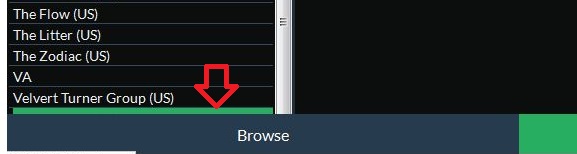

Hello Tim
I noticed a little problem on the TR3 release.
Artists in the column, the last box does not appear.
I use Firefox or Chrome.
Resolution 1440/900 of the screen.
By against copying speed considerably increased, bravo. (USB on the rasp)
Regards
jack

Bug
with the picture is better.

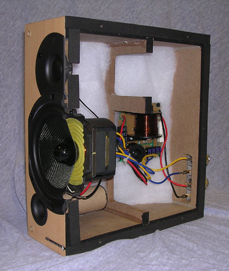

Hey Tim,
Just built a new Moode system with a pair of Wharfedale Diamond 9.1s, Hifiberry Amp+ to use as a portable (modded wifi to be its own AP) player for functions, etc.
Fantastic, as usual. Just about to give synced play a shot, now I have multiple systems in one house.
You seem to be busy 🙂
Hi Mike,
I forgot to ask about those super nice Diamond 91's Did u buy used or are u original owner. What a great set of speaks 🙂
-Tim
