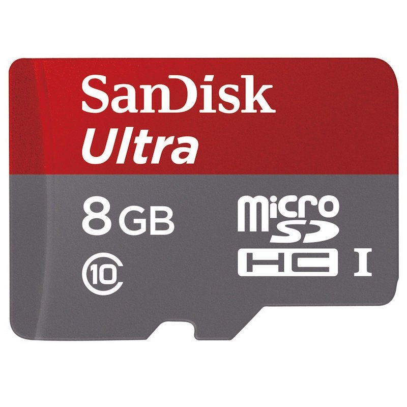

I've been using Sandisk Ultra Class 10 cards. Mine get heavily stressed during testing and no issues so far.
-Tim

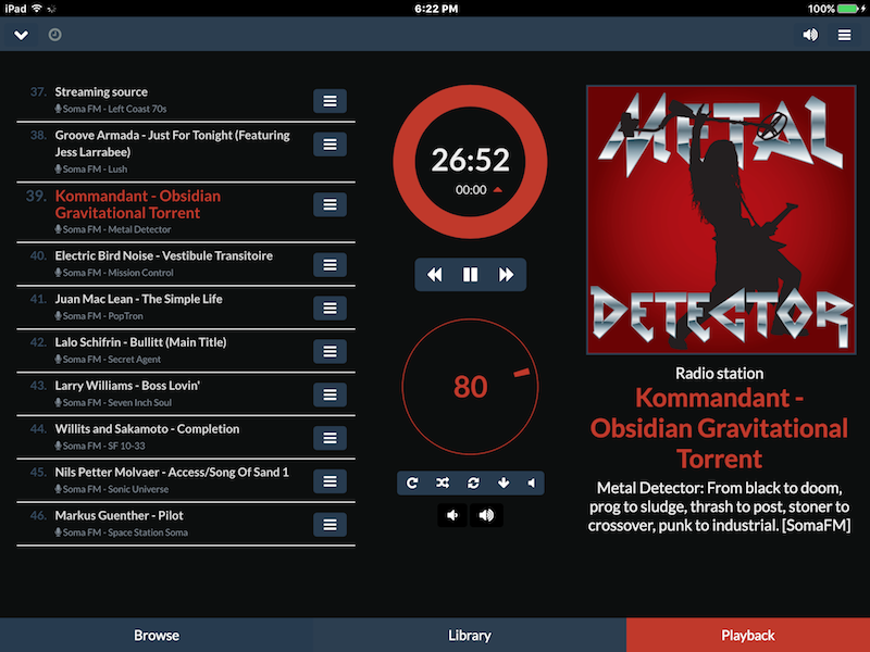

Moode Audio Player release 2.5 is available for download at moodeaudio.org 🙂
This release has many new features, improvements and bug fixes. Please read the attached release notes and view the updated player setup instructions for more information.
Enjoy!
Tim Curtis
2.5 Release 2016-02-27
New features

Media
- NEW: Eldoradio (Eldo.lu) 256K stream
- NEW: KCMP 89.3 FM - The Current
- NEW: MPR - Minnesota Public Radio
- NEW: SomaFM - Logo for DEF CON Radio
- NEW: SomaFM - Metal Detector - From black to doom, prog to sludge, thrash to post, stoner to crossover, punk to industrial.
