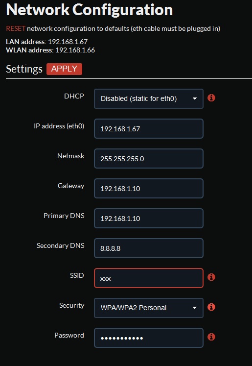

Hi, Tim
I have two errors
1 - The file /etc/network/interfaces after settings have the following lines:
auto lo
iface lo inet loopback
auto wlan0
iface wlan0 inet dhcp
wireless-power off
wpa-ssid "xxx"
wpa-psk "xxx"
allow-hotplug eth0
iface eth0 inet dhcp
After I editing the file, it has the following lines:
auto lo
auto wlan0
wireless-power off
wpa-ssid "xxx"
wpa-psk "xxx"
allow-hotplug eth0
#iface eth0 inet dhcp
iface eth0 inet static
address 192.168.1.67
netmask 255.255.255.0
gateway 192.168.1.10
Network settings menu takes the form, as shown in the screenshot.
If you then try to change something through the menu, the file becomes the initial view,
that is, the Wi-Fi settings can be changed, but you cannot change the LAN settings.
DHCP for LAN is not disabled.
auto lo
auto wlan0
wireless-power off
wpa-ssid "xxx"
wpa-psk "xxx"
allow-hotplug eth0
2 - After I change some settings, Customize menu disappears. (My browsers Opera 12.18 and IE 11.)
The problem with the Customize menu appeared in version 2.5, the problem with configuring LAN was in TR3.
Sorry for my English, is translated through Bing
Regards, Serg

Hi Serg,
I'll check on the issue with Customize and IE11.
The network code is mostly original and it does not support static address assignment for WLAN. Also there are a few bugs in it for example if the password has an embedded single quote it is not stored in the database correctly. Finally, if u edit the interfaces files manually it will be overridden by changes made in the UI.
For the time being, if u need static address for WLAN, edit the file but don't use the UI to make any changes except RESET.
Tim
